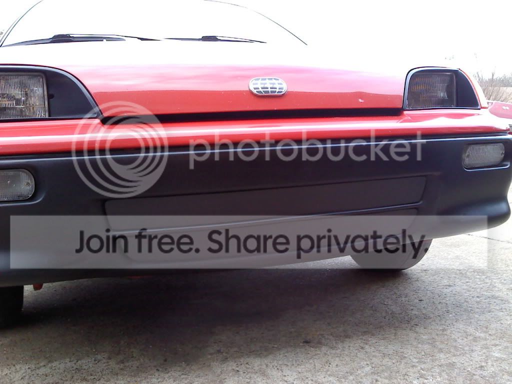

Grill block 100% and air dam. In very cold weather I also block a major portion of the rad itself with cardboard for my highway commute. The grill block is done for mileage improvement but also aids in winter warm up.

:gp I noticed a BIG difference in how fast my car got up to temp after the grill block.

I had a grill block once (along with numerous other MPG mods) , but my grille block screwed me once. The grill block was the second best mpg mod I got on Christine besides the 3Tech cam and gear combo. On my way back from Geos on the Gulf 2010, the fan quit working causing me to overheat and have several stops trying to figure out the problem.
Blocking the front end and making it rounder helps with aerodynamics, but the fan will run more. When it fails, it fails when you can't afford it.
