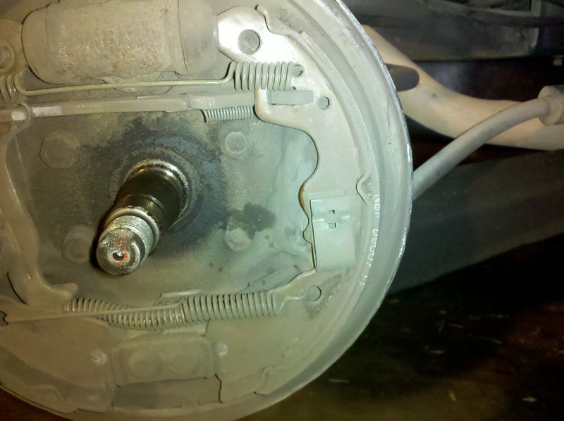

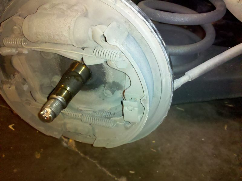

Well now I feel stupid for starting this thread. I didn't realize you have to remove the axle nut (the drum came right off after I did). I was used to a different type of drum brake. The kind where the drum cover slides off the lug nut studs. Question though. How much meat is supposed to be on the drum brake shoes? Do these look like they need to be replaced? ![]() ![]()
| Woodie | Nov 3 2012, 05:02 AM Post #9 |
Those are about half gone, meaning you have 100,000 miles left. not quite, I'm exaggerating, but you should get the idea. They last forever because they don't do anything. Since you have them apart anyway, you could just go ahead and replace them. They're cheap, and you'll never have to worry about them again. That brake cover you're referring to is called the drum. Edited by Woodie, Nov 3 2012, 05:03 AM.
