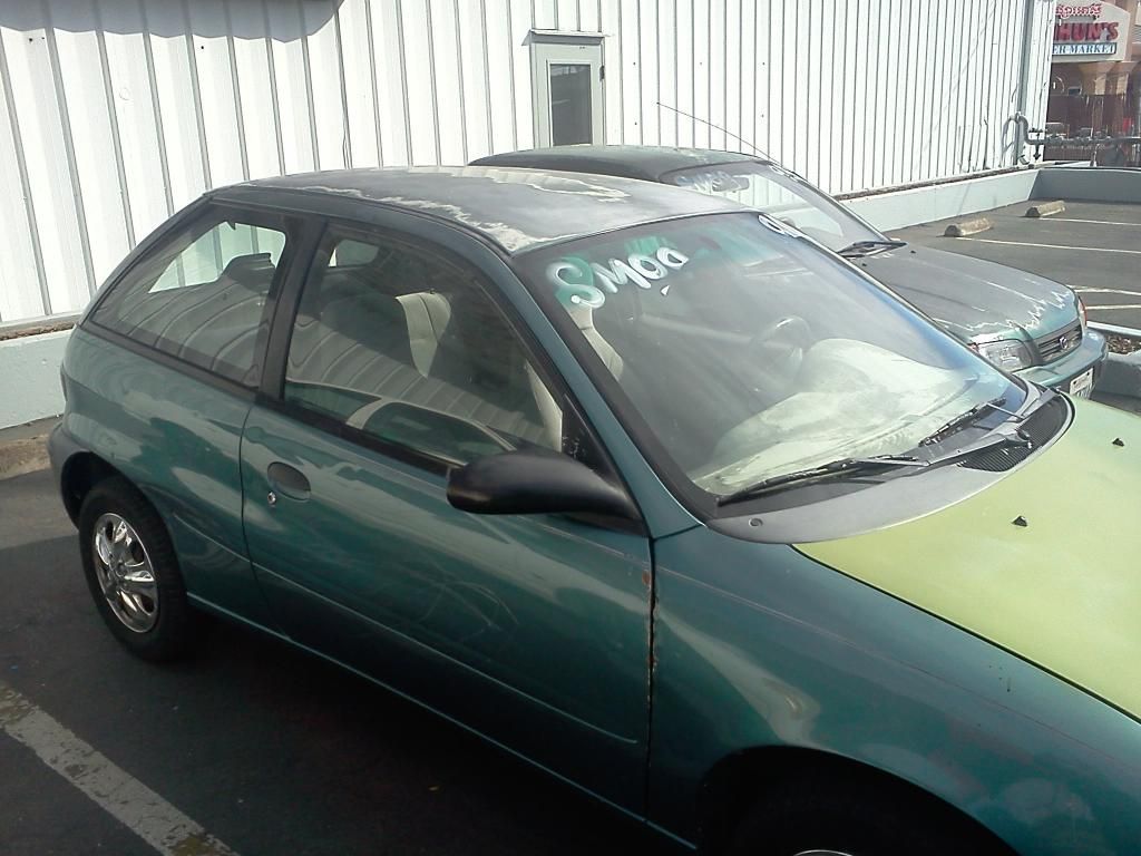

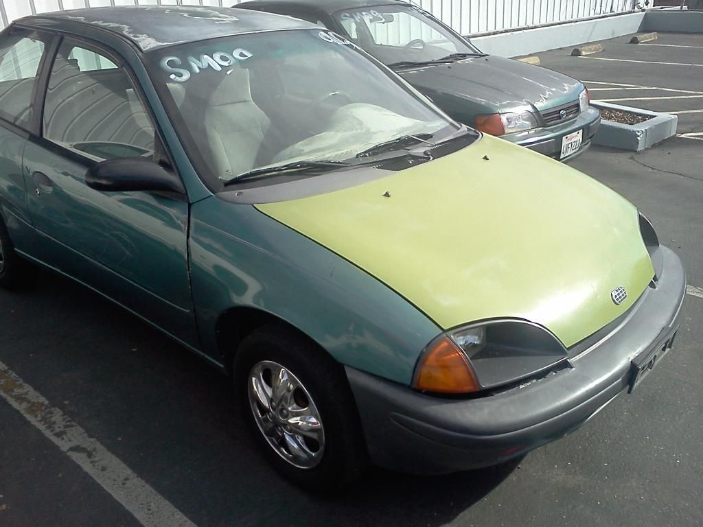

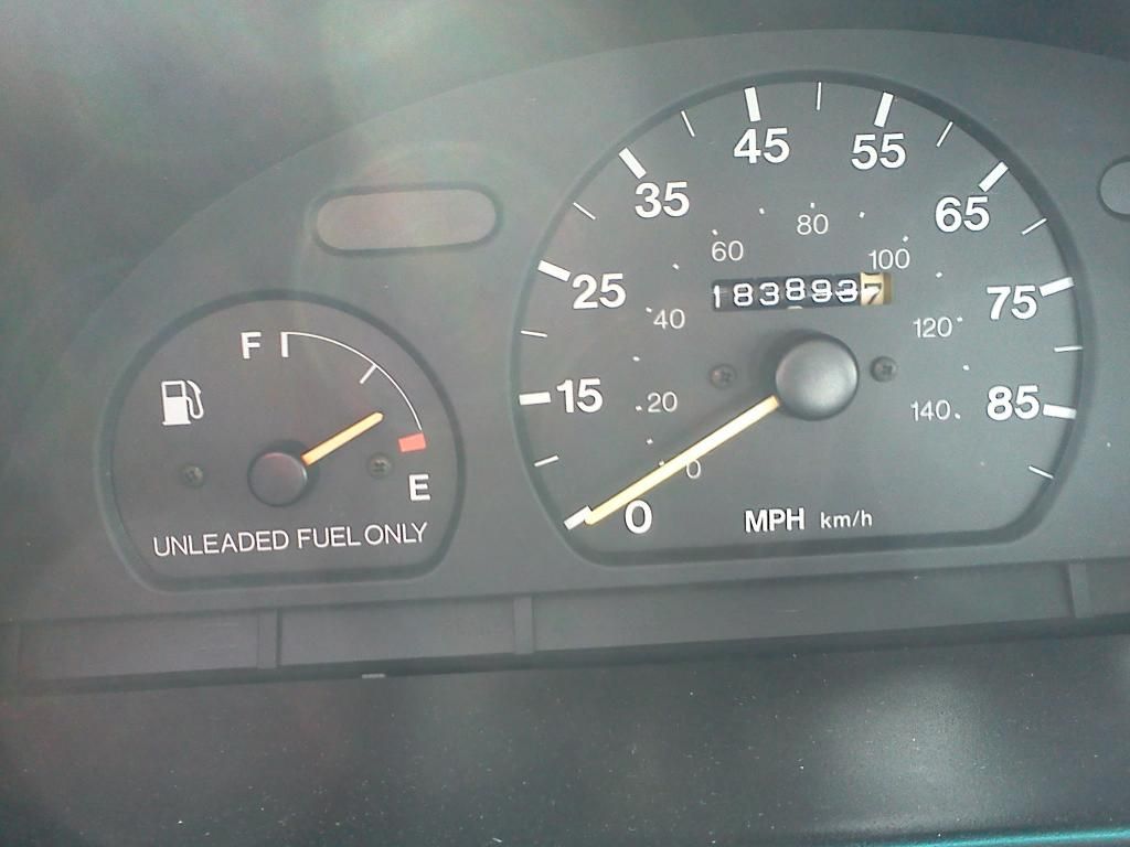

So I currently drive an '07 Silverado and I'm tired of getting 17mpg. I live in the Sacramento area, and have family in So Cal that I visit about once a month. I'm looking at this car to commute to work, as well as job sites that can be 100 miles away. I'm currently looking at a Metro that's for sale for $1000. it's a '96 Metro 3 door hatchback. I has Airbags, AC which blows, but I did not feel it get cold. It's green with a light green hood. Is $1000 a good deal? It has 184,000 miles. This car would be bought by a tow yard, and they wouldn't let me drive it on the streets, since it had no plates. They let me drive it in the back, but I really couldn't They have the title, and they got it's smogged and registered until 2013. It seems to run fine, but I hear a little clicking/tapping noise coming from one of the cylinders. What are your guys' thoughts on these cars. From what I read, they seem pretty reliable. Would it be able to make multiple 450 mile trips? I would be taking a gamble on the car, since the tow yard really knows nothing about it. It was towed, and the owner never picked it up after 45 days. So now the yard is selling it. It looks like it will need new tires, head liner, A/C recharge or condensor, and a tune-up. I figure since it's smogged and registered, it was driven pretty normally. Do you guys really get 44 mpg on these things? Are the parts as cheap as they say? Would it be able to make the road trips? Thoughts? ![]() ![]() ![]() ![]() ![]() ![]() Thanks, Danny |

Our engines will run how ever many hrs they need to. Period. The car is a little beat up. But should give you good service. Do they have a title on it? Not a salvage title. And you are interested in the compression #s. Some of our members are getting well over 50mph no problem. Alot depends on what mods you do, and how you drive it. One question I do have is why is it sitting in a tow yard? And do they have the legal right to sell it? A decent Metro for about $1000 any more is a good deal. You might have to do some maint. But with feul getting more expensive. The value of these cars is increasing. How many sub compacts can say that? |

The buyers guide is here: http://geometroforum.com/topic/1666576/1/ Rust is your enemy, check carefully, it can be repaired but it is a lot more effort. If you can compression test it so much the better, that mileage is typically about the time a rebuild is needed on a car that has received so -so maintenance during its life. Many members have more but they have taken care of their cars. http://geometroforum.com/topic/2574993/1/ Factory fresh is 199psi, factory minimum is 156psi, the car will run well below the factory minimum but "performance" will be less. As far as running for hours on end a Metro will run much longer than you can without an issue. High speed is a relative thing... Best fuel mileage typically comes in the 50-55 mph range, a stock 3 cyl/5 speed with a healthy engine will go 85 ish or perhaps a bit more but mileage will suffer badly. 60-65 is a reasonable compromise that is where I run and with about 50k miles on my rebuild I average 49 mpg. Running A/C continously will drop mileage 5-7 mpg. As mentioned if mileage is your goal then the 5 speed 3 cylinder version will return the best numbers, the 5 speed with a 4 cylinder will give a few mpg less and any version of the automatic will come in dissapointing low compared to the manuals. If you are able to do your own work then a Metro can be a very good deal for you. If you are paying someone else to do the work it can get expensive. Good Luck! |

rust? check for rust. if no rust issues and it runs good YES you can get over 40mpg with it driven right and yes its worth $1000 if you can afford it. if you can "DIY" your own maintenance its a VERY affordable car to own. there is pretty much nothing you can't fix your self with basic tools. |
| Nyquil-Junkie | Nov 3 2012, 10:44 PM Post #13 |
Buy it, plan on another 1000 to bring it up to daily driver condition and if you spend less, you're ahead of the game. If it's not rusted in the bad places... there isnt much 1000 bucks wont cure on it. |
