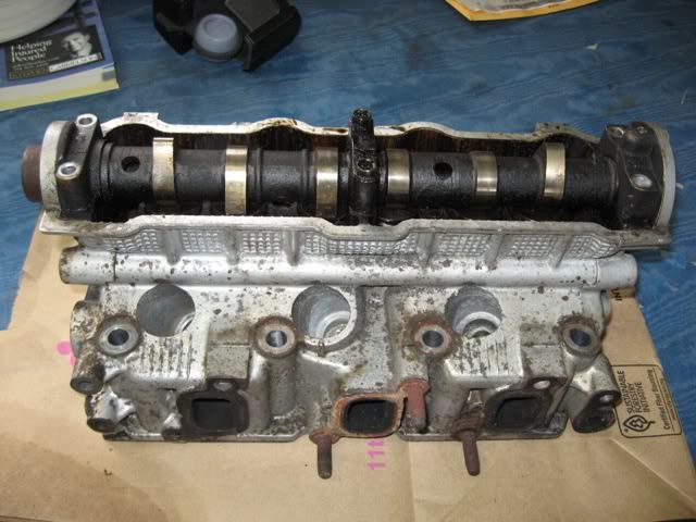

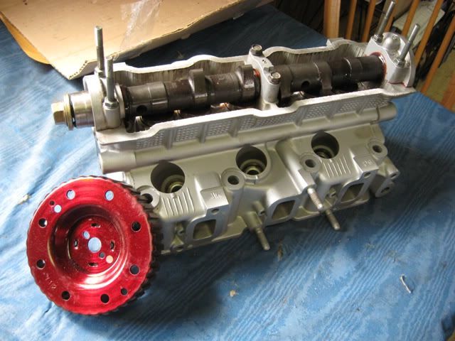

| snowfish | Nov 9 2012, 04:00 PM Post #10 |
XFi![]() Stock ![]() Performance
| Shinrin | Nov 9 2012, 04:42 PM Post #11 |
Thanks StarScream, couldn't remember for sure. |
| Old Man | Nov 9 2012, 05:30 PM Post #12 |
Logic is all that is necessary. If his cam looks the same as the one he is buying then it is not an xfi that is for sale. |
