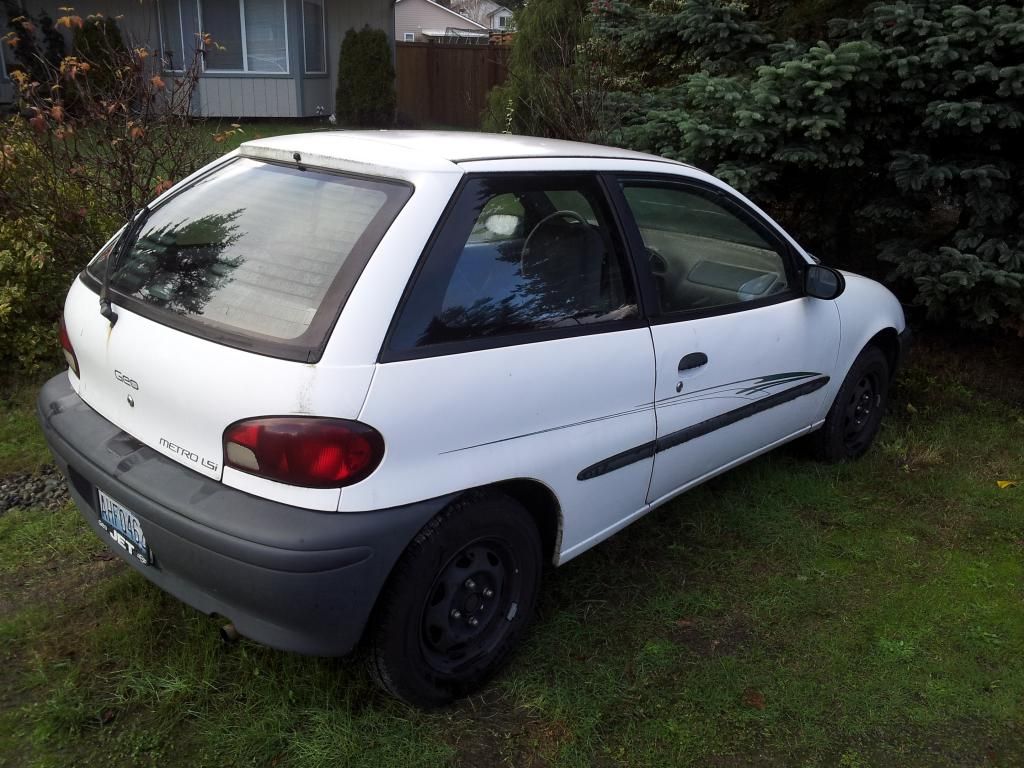

Picked up this 1995 4/A LSi hatchback a few days ago from a friend's coworker. The car still ran...usually...but it was starting to nickel-and-dime her to death. It occasionally wouldn't start, sometimes ran rough, and appeared to be running hot.
It has 216k, but when I got in it and hit the key it fired right up! No rust (except the nickel-sized spot under the rear wiper), tracks down the road nicely, and even has BRAND NEW tires on it. Also had a new battery, radiator, and a freshly serviced transmission. Completely stock, right down to the radio. Even has working AC! :cold
Condition is...dirty. Very dirty. Inside and out. Just like we usually find them. Ironically, years earlier I had randomly offered to buy this particular car before but was turned down. I didn't even know this same car was my friend's coworker's car until I went to pick it up! She told me the car's original owner was her boyfriend's father.
Found out it is in desperate need of a tuneup. Seriously, the gap on the plugs is about 1/8". Probably why it occasionally won't fire up. And a loose plug wire was the likely cause of the rough running. Compression is 150-170 all the way across. I think a thermostat would solve the overheating problem.
As far as I am concerned, any car you can drive away for $250 is a good deal. :rocker

Lucky you! Don't see a dang thing wrong from the pictures that a little elbow grease won't cure...

Went out to start this thing when I got home from work so I could pull it into the driveway and tinker with it. Cranked, cranked, cranked, but wouldn't start. I popped the hood, put the new plugs in, and it fired right up. Some of the most worn plugs I have ever seen.
Pulled the thermostat housing to put in a new one and found it already had a fairly new thermostat...installed upside down.
Gotta love people! :smackface
