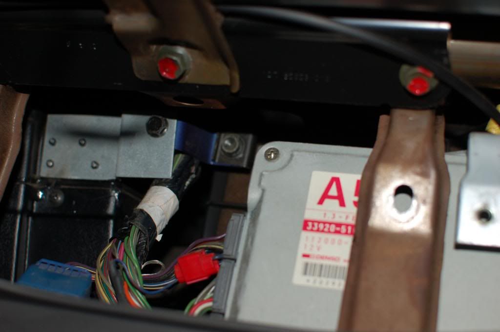

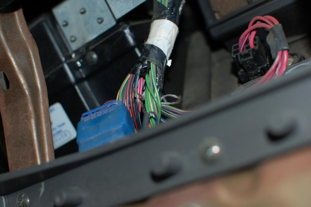

In another thread I started, I show a pic of some splicing of a few wires in the ECM's harnesses. But, I untaped a little and it looks to be a ground wire that runs with the wires, not spliced into them. The only wire that has insulation cut with this wire spliced is the green/blk sensor ground. I think this was the last owner's solution to the MIL illumination. I am guessing he ran parallel ground wires. I am going to tear into the harness after I get home from work today. I already told the wife to not expect me inside the house for a few hours!
The wires he ran the bare wire in the following pic were red (C2, O2 Sensor input), orange (C2, Ign Ref Low), white (C2, Ign Ref High) and green/black. The green/black (sensor ground) has the bare wire in the pic soldered on. The bare wire then splits and runs up the red, orange, and white wires. Where the bare wire ends, I have no idea. I would hope that they are not spliced into those sensor wires, but am not for sure.
Here is the wiring...
This is a bare wire that is taped onto some other wires.
This is a quick splice and there is another one on a different harness. This was the blue/red (C3, A/C Idle Up circuit) spliced into the blue (C1, Rad Fan Relay Control). I think this was done to raise the idle when the rad fan kicked on.

Tonight I am going to rip into these harnesses and find out where that bare wire goes. I seriously doubt it is factory wiring. Since it is wired into the sensor ground, I think it might be causing the 31 to be stored. But, that sensor ground also goes to the TPS, O2 sensor, Coolant sensor and IAT sensor. If it was spliced into those other sensors' wires, I don't understand why I am not getting a bunch of codes.
