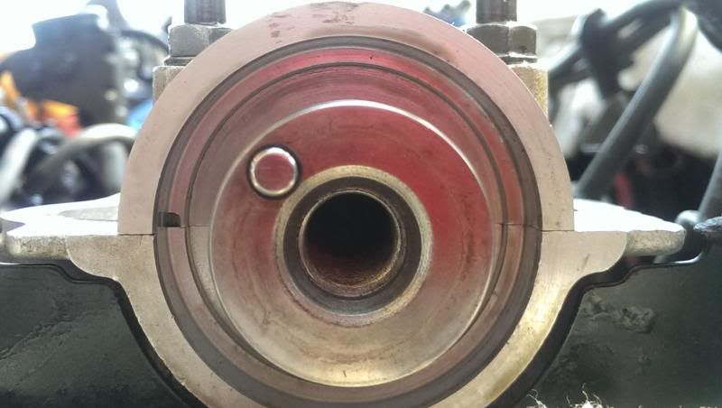

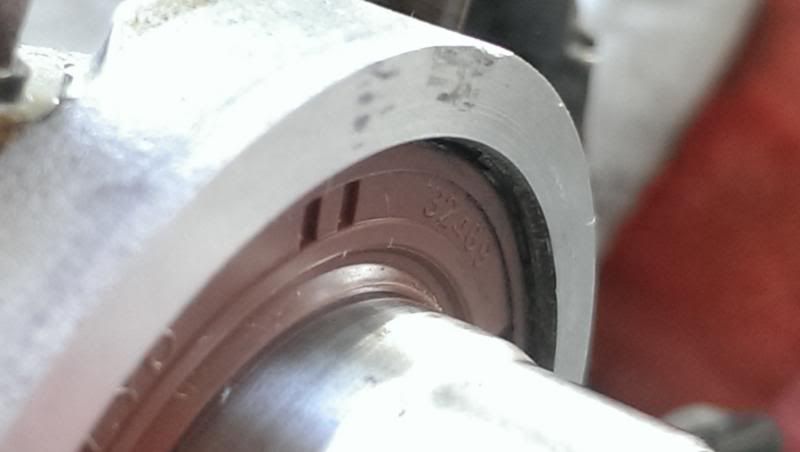

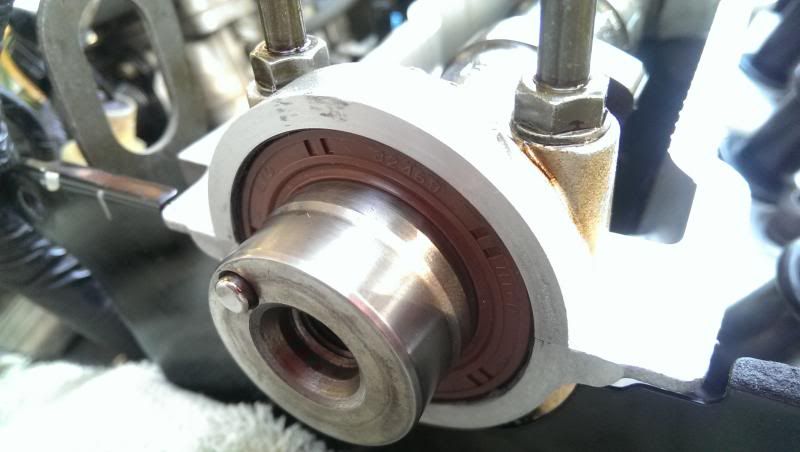

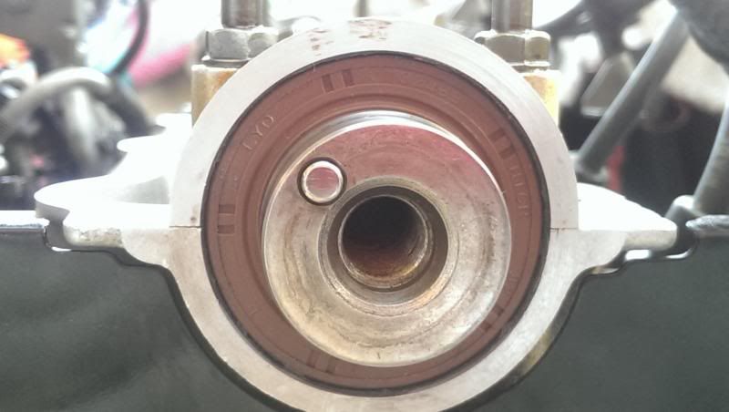

Also, the unmolested engines that I have seen do not have the camshaft seal pushed all the way in against the machined surface. A little attention to detail goes a long way.
Man - DID I PUSH THIS IN TOO FAR ? :-/
BEFORE INSTALLING CAM SEAL - AND AFTER SOLVENT CLEANING OF AREA
AFTER INSTALLING CAM SEAL - NOTE: rtv black - very thin layer used on the outside surface
Edited by Pilot-Terry, Apr 28 2014, 01:27 PM.
Yes, you pushed it too far. It should be flush with the outter housing. If you have no issues, do not worry about it.
Really Doc? :smackface Isn't the oil drain going to be blocked? :news
http://geometroforum.com/topic/5053891/1/
Why wait until we have a problem. :'( Seals are cheap. :deal Pull it out and make it flush. :thumb
Pressure will likely push it off just enough and unblock it and allow oil to flow. If the car runs with it like it then there is nothing to worry about. Oil is getting back across the other side thru the journal or some way. As long as it does not leak, I would not worry about it. If the cam cap mod was done that I do then no worries anyway. Plenty of gap for oil flow.

A couple hundred miles - no leaks - but yep, they're cheap - next time in there or the first sign of a leak I'll replace it.
No reason really for a new seal. If it comes out, just make sure the relief groove is not blocked with rtv and do not install it so deep but only flush with the outter housing. Reuse that seal. The seal itself is not bad.
