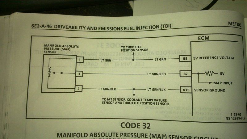

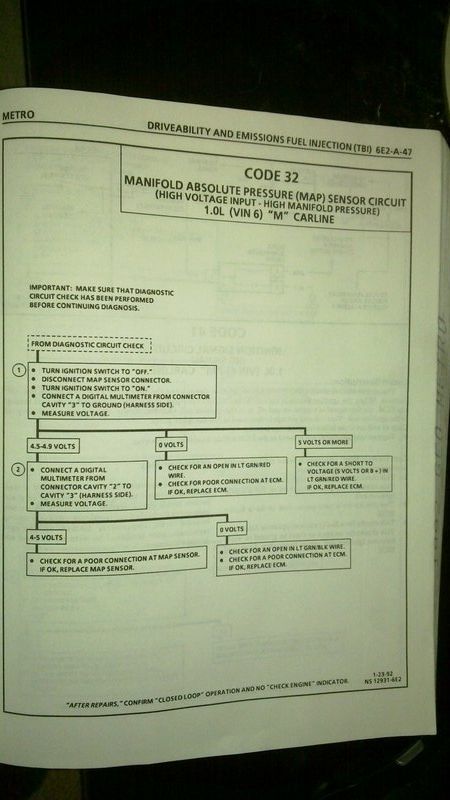

OK,
I ran the voltage tests as the last poster explained about the ECM or wiring issue, over my MAP sensor issue. This may not be good!
Firs off, I was unable to see any numbers for the little pin connections or cavities on the connector plug. There are 3 connections in the MAP plug, 2 of them are copper color the other is plain silver color. So, I'll go by the corresponding wire colors to the pin connectors. I tested all 3 connections.
Connection #1 the silver color connection inside the plug, or the plan green wire: (4.97 volts)
Connection #2 or the Green and Black wire: (0.01 volts)
Connection #3 or the Green and Red wire: (0.05 volts)
Yes, this was done with the plug connector (unplugged) and I did connect to the NEG post on my battery.
I hope I haven't just opened up a can of worms here!
Any ideas out there for me?
As always, THANK YOU ALL for the help, it's very much appreciated!
Bill.

5 O'Clock Charlie
Hopefully these will help ......
Posted Image Posted Image
