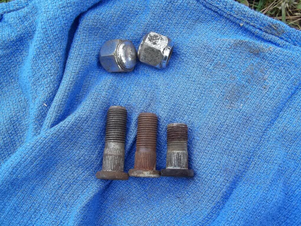

Lost 2 drivers side wheel lugs and broke the studs. Checked all 4 and found the rear vs front passenger side had different studs where the drivers was mixed. Sees there are different studs for the rear vs front and the drivers side had them mixed up. 50 bucks later and a lot of hammering I got the drivers side like the passenger side.
| UncleBranton | May 14 2014, 09:36 PM Post #5 |
Just saw this and thought I would add a pic so people know what your talking about.![]() The one on the left is a stud for the front wheels, the one in the middle is for the rear wheels (shorter). The one on the right is my broken rear stud. |
