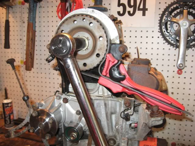

On such a refresh, that I did awhile back, the Cam Sprocket was held by a strap wrench.![]() Worked great. |

The punch I used Was a good one lol It went in well but still bent up pretty quick. Snowfish I like that strap idea, Ill probably try that |

I just used a #2 phillips screw driver. Works every time. The strap wrench is a GREAT idea. |

Thats badass too! Im definitely getting a strap wrench or chain wrench tomorrow |
