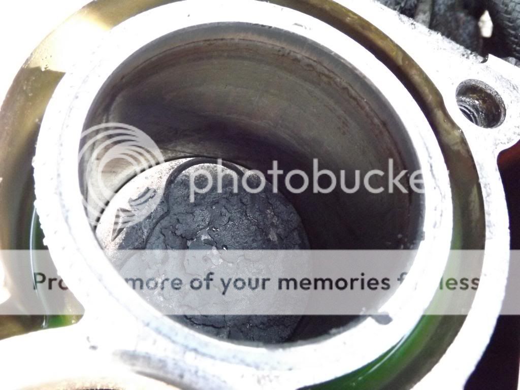

Ok wow, well it looks like the previous owner didn't really keep up on anything. I'll let some pictures do the talking. The Egr ![]() The Egr passage on the intake ![]() Inside of the valve cover ![]() What the block looks like (No I haven't scraped the gasket off yet, yes I am going to clean the check valve) ![]() Cylinder 1 (I rotated them all so you could see what the inside looks like )![]() Cylinder 2 ![]() Cylinder 3 ![]() The Head with valves ooh toasty ![]() The head without the valves (notice the hammer and socket lol) ![]() Ok now for the Q&A *The egr I'm just gonna blast the piss out of it with carb cleaner, then hit it with some heavy duty pipe cleaners. usually does the trick 1. How does the valve cover look? Should I just spray that with some carb cleaner and scotch pad it? 2. Obviously those pistons are a mess but more importantly is the rust on the cylinder wall. Should I just push the pistons out, clean those buy a hone for my drill and hone the block? If so what grit hone? (17v DeWalt & 18v B&D ) 3. Whats the easiest/best way to clean those pistons, valves and head? (I have new SS 3 tech exhaust valves) I have no chemical tub or anything like that. Should I just buy a wire wheel attachment for my drill? <And on that note what kind of wheel? I've heard I should buy only brass because it's less aggressive 1,000 Thanks for any help guys, and I've looked up several things with google I was just curious what people had to say about my specific shitty situation. *Also I bought a strap wrench and it didn't help me get the cam sprocket off... I'll probably just take it to the auto shop at my college and see if they'll just impact it off. |

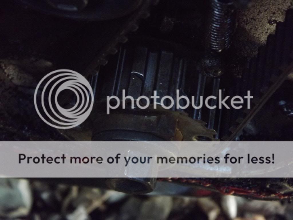

Oh yeah almost forgot Here's what my cam looked like on ![]() My crank timing sprocket? (not sure if that's what it's called) I'm assuming those little chunks missing is bad...also the key in-between those two bolt holes on the right that looks bent ![]() Should you be able to see the flywheel like this? just wondering. Also check out my sweet ultra poormans ghetto fix on the exhaust that's falling apart. But it's ok because I get my taxes in a few days so I'm probably just going to get nice exhaust

The EGR doesn't look too bad, mine was completely clogged. Valve cover looks fine. I don't know what exactly happened to your pistons but they look like mine did when I had a blown HG. You shouldn't be able to see your flywheel like there, there is a cover that's missing. The rust in your cylinder walls looks like surface rust, hone it and see what you get. |
| Johnny Mullet | Feb 5 2013, 08:26 PM Post #7 |
Let's continue where you left off.............. Drop the oil pan. Remove the connecting rod caps. Push pistons out with a wood dowel. Save bearings and caps keep pistons and all in order. Inspect all bearings, only replace if shot. Remove piston rings by rolling them off. Soak pistons overnight with purple power. Clean piston tops and top sides (not skirts) with wire wheel. Clean piston grooves with pick or old ring. (time consuming) Liberally spray oil in cylinders. Hone each cylinder 10-15 seconds each (pull out with drill running when done) Clean the fuck out of the cylinder walls. Check ring gaps in all cylinders. Lube the fuck out of cylinder walls with motor oil. Carefully re-ring pistons and install with ring compressor. Careful to put crank with rod connection down before installing piston and don't nick crank. Remove fucked up crank gear and replace crank seal. (see how to) Find new key and crank gear and check slop in crank with new key. Of no slop, install crank gear and bolt and torque. If sloppy, pack with JB Weld, estimate "center" and install gear and bolt and torque. Use head repair guide to do head. To clean carbon from intake valves, use a small hammer to break it up and chisel off carbon with a good, sharp, small chisel (do not use a vise or vise grips to hold valve, use hands) and the seat area will clean up when lapped in. Good luck! |

Not great but not so bad. Get yourslf a factory service manual - you will pay yourself back many times over with the frustration it will save you (ebay is your friend here). Check the head for flatness. Either have a machine shop do it (best) or you can get a rough estimate with a framing square and feeler gauges. If not flat or the sealing surface is pitted, get the head surfaced. There is LOTS of material on the head that could be removed if required (I've read as much as 100 thousandth...) Buy a decent head gasket, I've had good luck with Felpro - avoid Apex and Evergreen (unless you really want to do the job twice). lubricate bearing surfaces as you re-assemble them. You can use motor oil - I like Lubriplate assembly lube. Get a new O2 sensor, after the abuse the old one has suffered to get to this point it's not likely it will perform properly. Get one with the proper connector already on it, avoid the generic version that would require you to splice on the connector. Get a new 195 degree thermostat, buy the better version here. Best kind has the little jiggle valve. Clean all the grounds in the engine compartment. Good Luck! Keep us posted. |

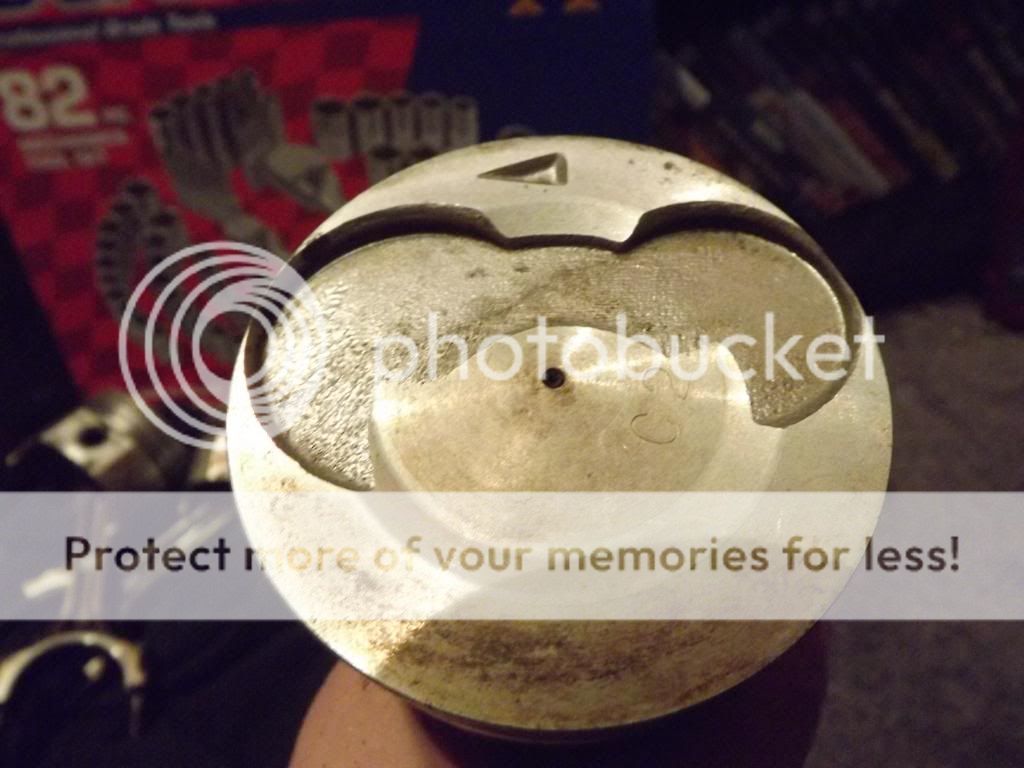

Ok so my pistons sat top down in a carb cleaner milk carton. They cleaned up really nice. I'm going to use these super cheap toothbrushes I got at walmart to do the fine detail cleaning to get the little bit of gunk left. Piston 1 ![]() Here's the bearing on piston 1 they all look like this. So are they fairly even? ![]() Piston 2 ![]() Piston 2 under the bearing. How do I clean this? carb cleaner and a scotch pad? Piston 3
