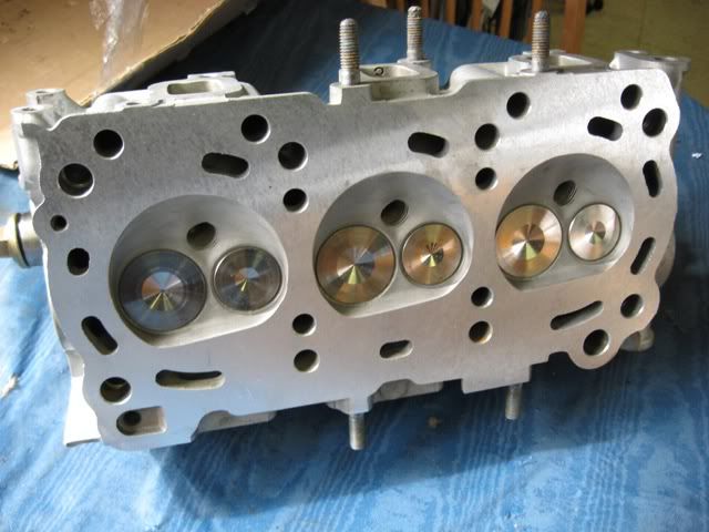

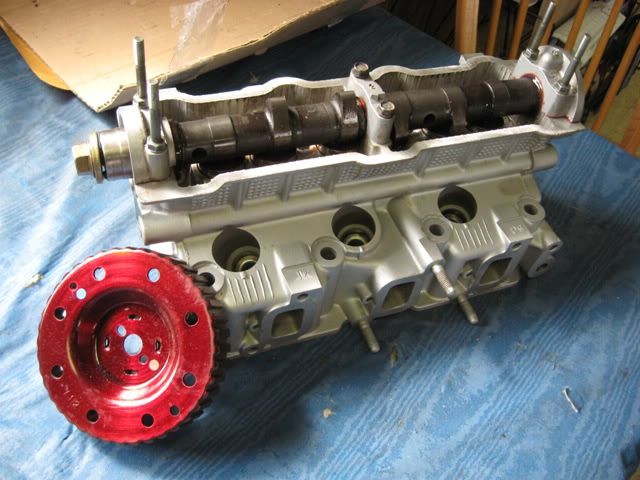

With the lifters clean, and with just a drop of oil, practically dry, there's a cam position that all valves are closed. ![]() ![]() The lifters are either too full of oil, or they were assembled incorrectly. A very, very remote possibility is that the new valves are too long.
