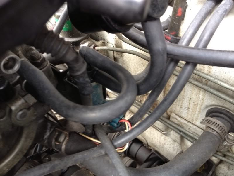

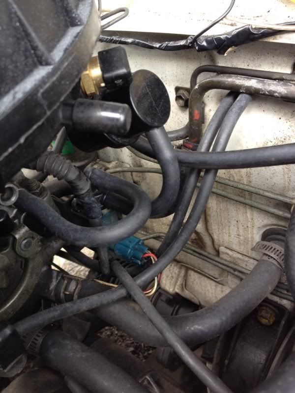

Maybe I'm an idiot or something but I took my isc apart, cleaned it all looks good, re install still won't idle right, so I wonder if I have it hooked up right. The hood diagram confuses me because it spears to be upside down. ![]() While mine faces up ![]() ![]() Do I have it hooked up right or wrong? Thanks! Edited by Vkhelldog, Mar 16 2013, 05:29 PM.

![]() ![]() ![]() ![]() ![]() ![]() Does this help? Also try swapping hoses, top to bottom. Edited by dayle1960, Mar 16 2013, 07:15 PM.
| Vkhelldog | Mar 16 2013, 07:33 PM Post #4 |
Yeah I need to try swapping hoses lol |
