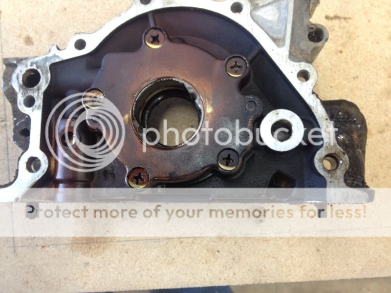

While taking the block apart to check everything and get it cleaned up I came across this part and have no idea what it is. See picture. It rotates with the crankshaft, is it some kind of speed sensor?

That part in the top pic is the oil pump. And I believe those numbers represent different sizes of the cylinders. Mine is 111, other people have 121, 221, etc.
Yup. That's the oil pump.

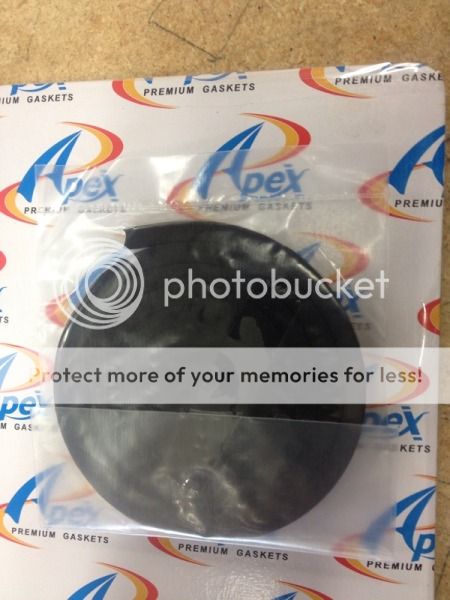

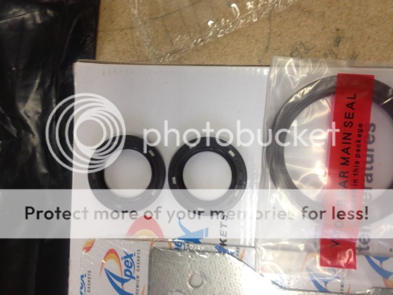

Here is my confusion. There is a roll of foam type stuff, what or where does this go? Any idea?

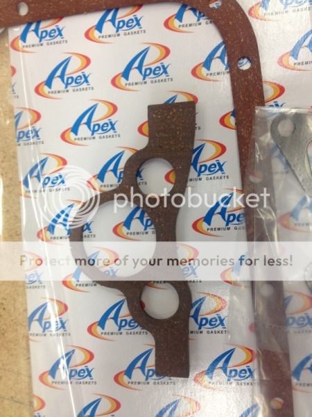

There is also this cork one.
And two of these little round guys. They look like what was one the oil pump to seal the crank shaft, but why would I need two?
Any help is appreciated.
Dennis
Edited by coveredinsawdust, Apr 30 2013, 09:24 PM.
Two little ones are cam and crank seals. On the accessory side of the engine. The foam is for your timing belt cover.
