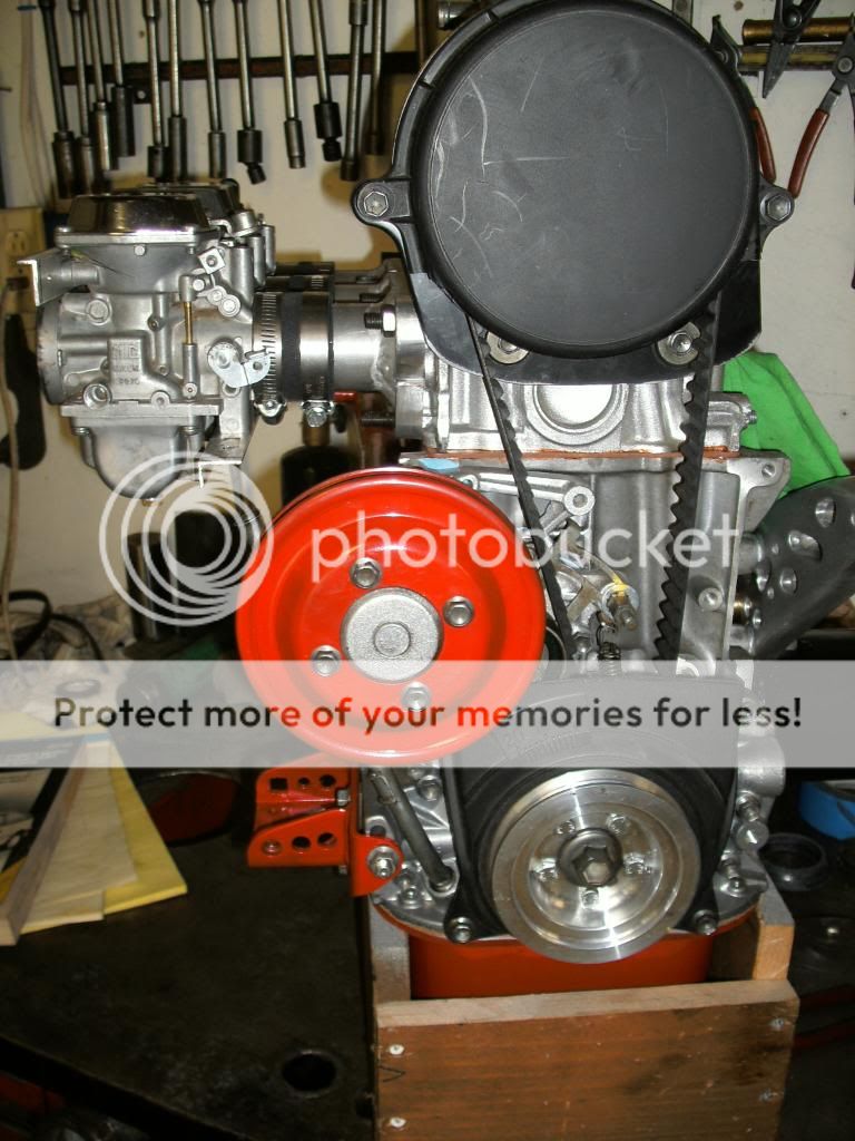

So how many fine folks here have foregone the horrendous impeding throttle body and opted for three single barrel carbs?? sounds like a good idea in my head......

Looks like that timing belt cover would save a lot of time changing a water pump. Is there a build thread on this? I feel like I missed a cool build...

Hey I recognize the sockets hanging in the back ground of that pic. LOL That paticular set of carbs did not work worth a hoot. We spent a lot of time and money on it. I am not done with the idea though. Our friend from MinnsotaDuane did a set also. One mistake I made when making the manifold was making it level. These carbs were designed to set a slight angle. And I think they throut was to large in each one. I would run smaller carbs next time.
That first manifold was made from scratch. My latest one was made from a stock intake. I milled off the TBI flange and tubes. So that just the side that bolts to the head was left. Then I counter bored the new tubes in place and the correct angles needed to match the angles the carbs set at on the bike. I think one of the mistakes with my first try was the carbs could not equalize pressure between them selves??? Maybe? So I used the stock intake flange. It has a been cross drilled from the factory so it can equalize the difference in pressure between each of the three runners. I hope.
The first set did look bad ass though. And when they did all work at the same time. It was mind blowing. But keeping them all running at the same time was to much.

Did those carbs have vacuum ports so you could connect a set of manometers? I used to ride a '79 Yamaha 750 triple (about 80 hp); when the carbs were properly synched, it made a huge difference. I never did find a bike shop mechanic who would bother to do a really good job of synchronizing, so I did it myself. When done right, the carbs would stay in synch for quite a while. This was on an air-cooled engine which lacks the thermal stability of the water cooled G10.

Those carbs are CV carbs with butterfly valves, and a vacuum actuated slide in front of the butterfly valve. They look an awful lot like Ex500 carbs or even three KLR carbs, but since the CVK carbs are used on a lot of bikes, it's hard to be sure.
The reason you had trouble was because of those carbs. Syncing them up will help of course, but that type of carb works a lot better with a properly tuned air filter box.
What you need are some slide carbs or pumper carbs from a 250 dirt bike. The hard part, however, will be getting the jetting right.
For a carb change, I'd look into getting a Weber 32/36 DGAV. Brother had one of these on his Samurai before switching to propane. It was great. I put one on my Mighty Max years back, and it completely fixed every single driveablility problem that little truck had, got me another 4 mpg, and a little more power to boot.

I've built a rice rocket or two in my spare time.. I was considering those carbs. Thoughts?? Probably some mikuni 36mm or so

There are a ton (50?) Miatas that were modded with IRTBs. You might see what kind of carbs they were using and downsize a wee bit.
