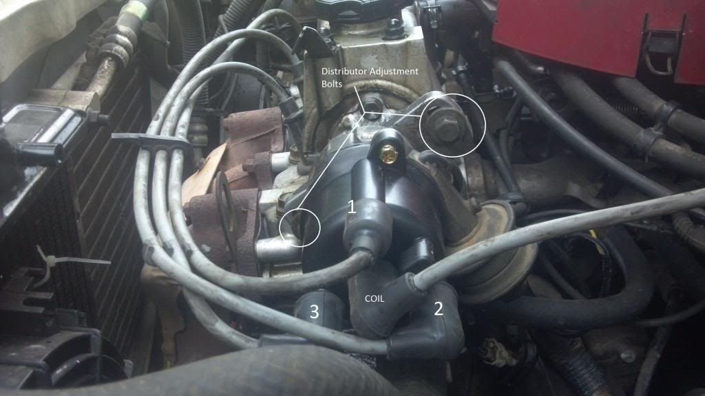

I know of a Metro mechanic in the Denver area. You. Nobody else is going to give a half a hump about these cars, certainly not the Chevy dealer. (The metro is actually a Suzuki.) It sounds to me like they have either messed with the timing, or put the wires back on incorrectly when installing the new distributor cap. I'm going to post a couple of pictures for you, so that YOU, capable single female that you are, won't have to depend on an apathetic mechanic to get your car running right. First picture, looking from the driver's side fender of the car, we see the distributor. Inside of this, there is a part that spins counterclockwise, transferring spark from the center wire (marked "COIL" to the wires going to the cylinders, (Marked 1, 2, and 3) when it is their turn to shine. Also we see the two distributor bolts. These two bolts can be loosened with a 12mm wrench, so that the timing can be adjusted. More on that later. For now, make sure your wires are hooked up as these are - number one close to the top, three on the lower left, two on the lower right. Trace the plug wires back from the plugs if you need to, the next picture shows how they are numbered. ![]() Second picture, here we show the front of the engine, with the spark plugs numbered 1,2 and 3, starting from the belt side of the engine. ![]() Now that you have the wires in the correct position, grab that 12mm wrench, we are going to try something. See those two 12mm bolts in the picture? See them on your car? Loosen, but do not remove them. See the brackets they hold down? Start your car, set the parking brake, block the wheels, and leave it in neutral - we are going to set ignition timing. With the engine running, grab the brackets with your thumb and forefinger, and you will see that you can rotate the distributor forward and back. Notice how the sound of the engine changes. If it slows down/sounds rough after moving it in one direction, move it back the other way. Adjust it to where it smooths out, but don't adjust it so far you get a sharp metallic knocking sound. Some will say you need a timing light to do this properly, but for right now - we are just trying to see if that's the problem without buying a $50 timing light. If my description isn't very good, or you are having trouble figuring out what to do, let me know - I will post a video showing this very simple DIY adjustment. Then you can do it yourself, and not spend a bunch of money for someone to make it WORSE. |

THANK YOU, Tinker! I'll go and hunt down a 12mm wrench and attempt this procedure. I used to actually work on my old VW Bug about 20 years ago, with that cool little book for idiots! I really appreciate your help and will let you know how it goes!!! Signed, your hopefully capable female. |
