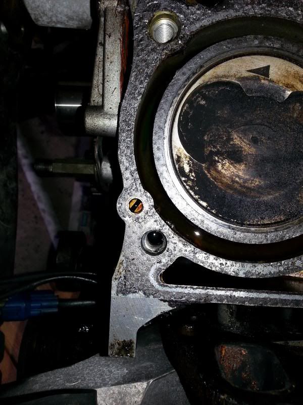

i just recently redid head gaskt on my 94 geo metro. i drove it around town,put50 to60 miles on it. idle was a little rough but seemed to run fine. so i was going to work and when i was getting on to highway and accelerated black-grayish smoke came billowing out of the tailpipe took it home immediately. this motor was installed 33 thousand miles ago. (remanufactured motor) i noticed oil in tailpipe and inthe air cleaner, am going to replace pcv but would the pcv valve cause this problem
new headgasket? Did you ensure that the oil restrictor stayed in place when you had the head off? Causes oil pharts if it is left out.
tam zachary
what is the oil restricter

what is the oil restrictor

old man what is oil restrictor
It is an item that fits in the oil passage in the block that controls the amount of oil flow to the head.

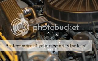

2000 Metro 1.3liter, 4 cylinder
wanted to replace PCV valve, looked at posts and pics.
not sure where mine is. do I remove the valve cover to get to it?
have two suspect hoses coming from valve cover, one of those?

Go buy one at an auto parts store. Then, ask the auto parts sales person if they will show you where it is on the car. They'll find in in a second, and might even change it for you.
Oil Check Valve in the block...
It's mounted on the valve cover, where the small hose comes out near the middle, on it's way to the big metal can of the intake manifold. If you remove the hose, the PCV valve just pops out of the valve cover.
i have the same year and engine. its right at the valve cover. cant miss it. change every 30k. by now you probly lernt that tho
