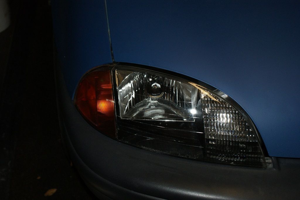

Another boring update but I hope this light review is helpfull.
The led bulbs I got for my reverse are way to dim so I got beefer ones and ended up using the others as front turn signals
way better!
very happy with these ones

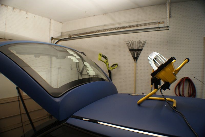

ok so I got my defroster glass in and been cleaning that up but now I've been fixing breaks and weak spots..
so many spots...
so I can see most of the breaks and line up masking tape.
I found only one of these in the state because i didn't want the stupid one time packet. I'm wondering If I could have gotten away with conductive pens they use for pcb repair..
Didn't have a test light so I rigged one up using spare led turn lamp and some gator clip leeds
tape tape tape (i readjusted the top one) you can see the breaks pretty good I had to trace about 5 with the test light too
It's pretty effective not to much excess I'll gently razor blade the excess i have two weak spots i have to redo mostlikely should have scraped some of the over coating away to recoat for those ones..
my car is garaged and so I haven't tested it out yet but the test light shows major improvements

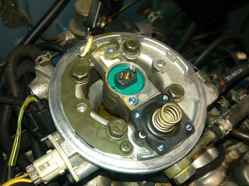

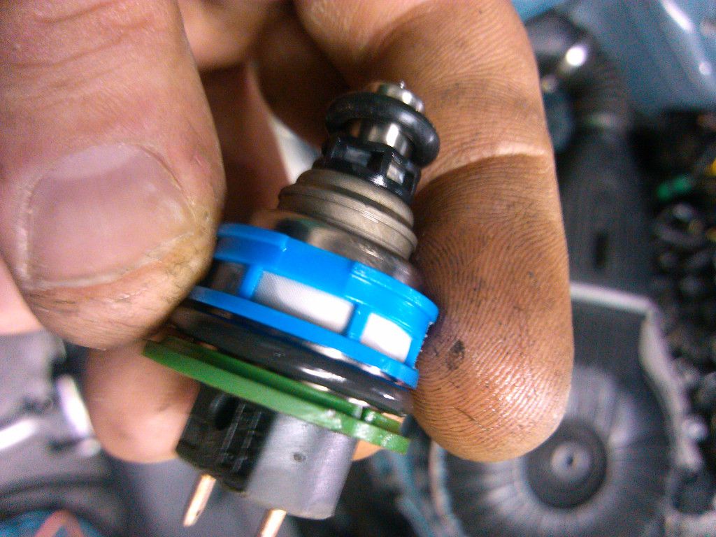

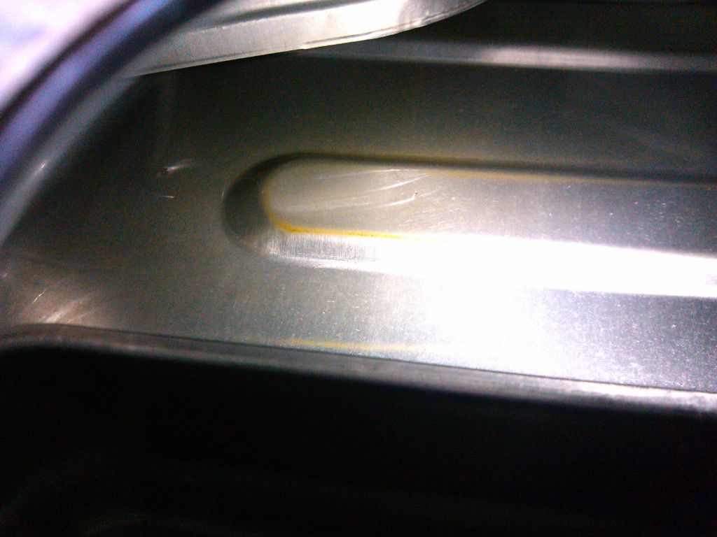

ok so playing around driving there's something to do with electrical ether blower or something else it idles fine today 32* till i turn the heat on then it revs in 2nd it will slowly pick up speed.
the t cable seams to be doing ok
time to check all my grounds and the heater resistor

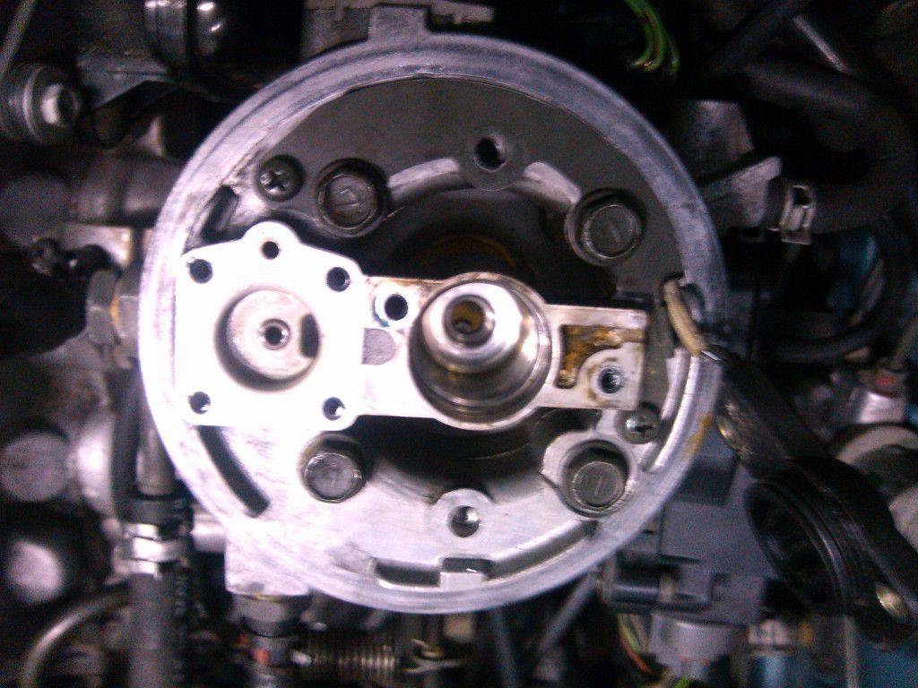

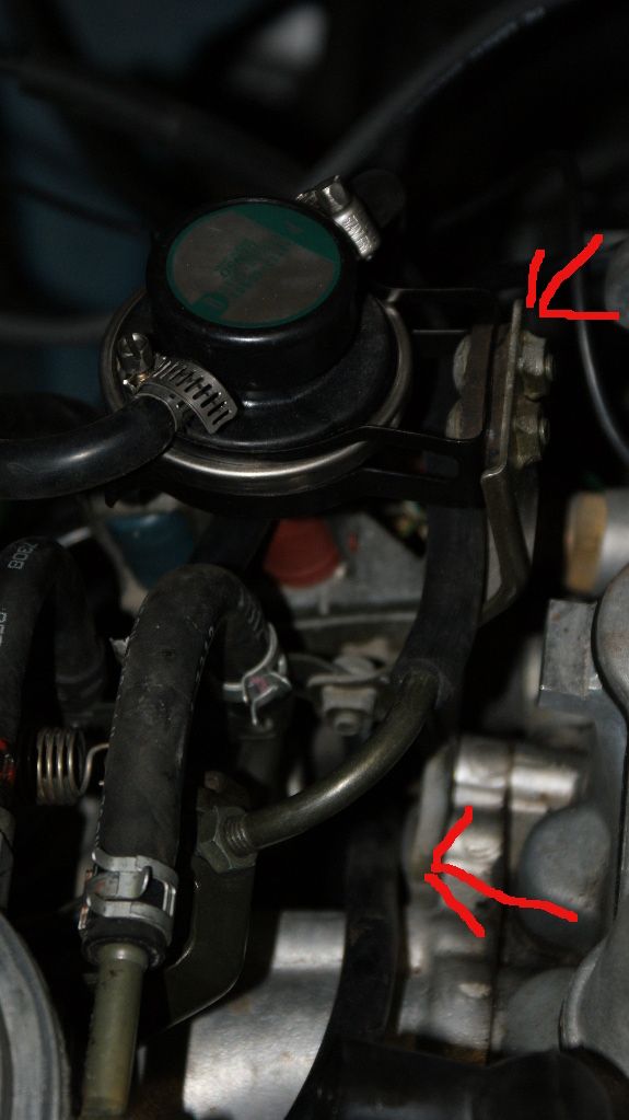

When you turn on the lights or heater fan, the PCM sends an idle up signal to the Idle Speed Control motor. I think that's where your problem lies. I also think it's in the black box on the back of your throttle body.
Panzerjunkie
Owner of Jazzy the Geo Dog
Dec 7 2014, 06:47 AM
Panzerjunkie
Dec 6 2014, 02:34 PM
sounds like whats up with the consistency of the tests could also be whats up with the occasional really cold coast rev up to
man I had my hands on a unmolested TB from a 95 swift (63k miles) thing looked new but I didn't have $40 so I had to leave it at the yard (they scrapped it)..
been kicking myself ever since :die
I have a couple of isc motors laying around from last winter and one tb not super clean but looks unmolested on the idle stop screw I may try swapping them out maybe I should rebuild that one too..
