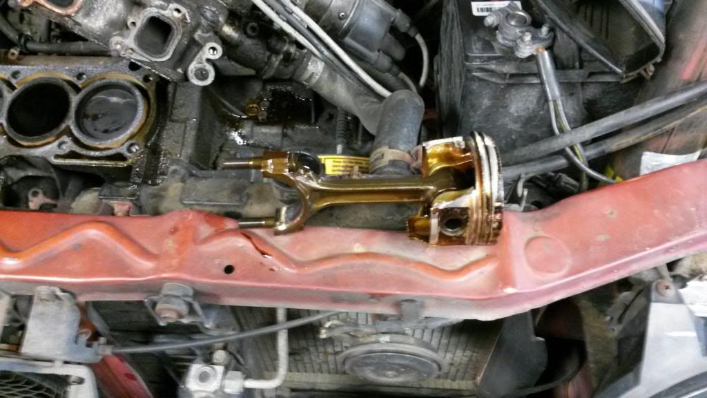

Coyote X has a 91 that had this problem and compression was good. When he came to GeoPalooza the engine started knocking. We tore it down and found this..........
All fixed now and no oil farts.
bbowens
you found a piston laying on his radiator support? :P
Mythstae
What is going on in the left of your picture? Looks... scraped...
