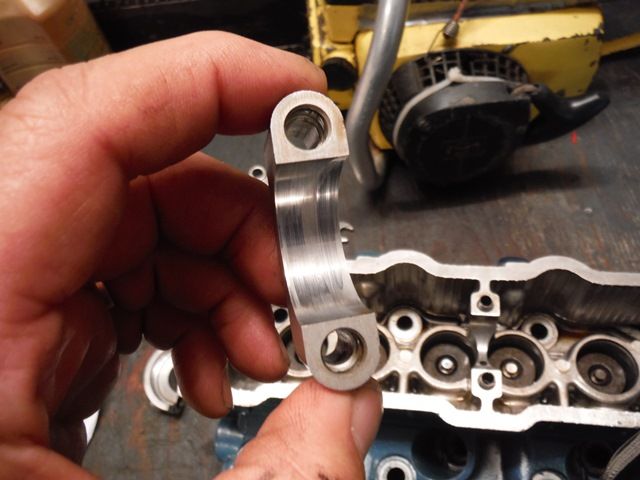

So after all this crazy about cams taking dumps looks like I'm the next victim. My cam and cam bearing are not looking so great.... I decided to look into my cam after seeing what happened to that cam Mell had.
This is my center bearing, it looks really scored. My engine has never been starved of oil or ever over heated, it never has leaked or needed any oil added so that is impossible. I change my oil way more often that is recommended so it can't be bad oil. I do have a 3tec life time warranty so I need to call them up and see what's going on here, could be just a bad cam?
Any one got ideas?

I never did like the look of those cut down center journals. The bearing surface is aluminum! Not a good choice to start with, why increase the load on it?
Bummer Jato! :'( Keep us posted on the verdict. :popcorn I Do know that a different cam, in that head, is not the answer. :shake That groove will not allow oil to disperse properly and destroy the rest of the journal, and cam, that you install. :die Here's mine after 1000 miles, with a normal center journal cam installed.
Oil farts x10! :stoner Brand new cam is scuffed up pretty bad too. I need to take a micrometer, to it, to see if it's still servicable. :news
Sorry for your misfortune. :( This summer has been a learning experience for a lot of us. One lesson is that the 365/222 cam is the final cam for a given head. :deal Fun while it lasts, but there's a price that will be paid. :x

I didn't know 3tec cut the cam journals down like that, this was the full head package assembled and ready for me to install.
Snowfish if you say installing a new cam will not solve the issue then I don't want to ruin another cam and bearing, I would almost rather just let it be all marked up untill I get a new head all together, I didn't even bother to look under the cam I can imagine the head bearing being just as bad as the top bearing.

The problem is there is no bearing. It's the head itself, so you have to get a new one (head) if it messes up.
That is correct. ^o) It will escalate a larger issue..........oil farts and boogered up new cam. :die
The head side will look pretty nice since all the force up is against the cap. ^o) However the caps are not interchangeable without machining & align boring. :gamerz Not cost effective at this time. :shake
As long as your engine is running fairly well, without a lot of clanging & banging, put it back together and run it. :drivin But not too long. Remember, you're introducing aluminum, more & more, into the oil. :'( Hopefully you've been running a premium filter. :hmm
Get another head, build it up locally, and swap it out more sooner than later. :gamerz Bummer deal, but I don't see how your head, or mine, can be returned to service with out major surgery. :x The things we learn along the way................. :tumbleweed
We'll I have my other head and that head is in amazing shape because it's still new-ish I'm just slightly disappointed that the 3tec head has only lasted me a few 10 thousand miles
