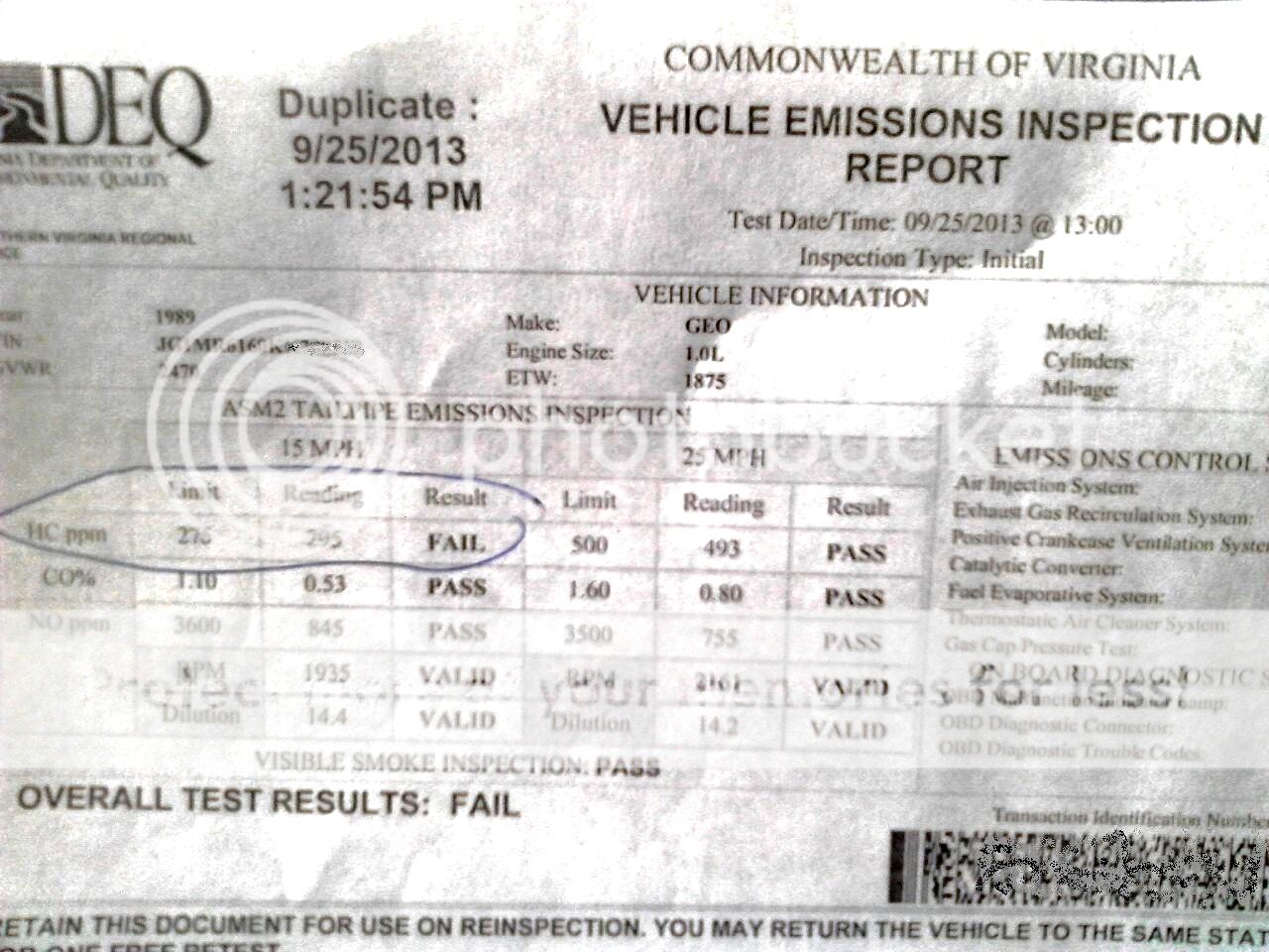

Just the the state of Virginia wants it to lose 20 ppm of hydrocarbons. Otherwise, I can't drive it until it turns Age 25 - in three months.

Here's the report if anyone can come up with ideas
I put some fuel injector cleaner in the tank and took the car out for an 80 mile run hitting 70 at times. Runs real nice. Hard to make a dent in the gas tank since it's getting around 48 mpg!

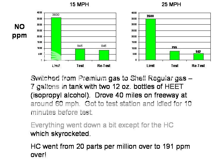

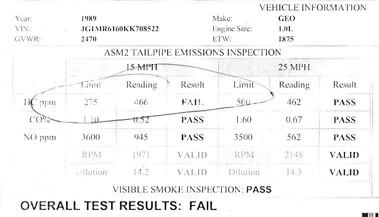

Went and retested this morning. No adjustments on timing. 7 gallons regular gas and two bottles of HEET. Drove the car for about an hour at 60 mph. Got to the testing station and left the car idling for 10 minutes or so before they could get to it.
Still fail and HC got worse! Everything else got better.
I made some graphs to compare the First TEST vs. the Re-TEST

I just got back from Test #3
50/50 mix premium and regular gas with two bottles of HEET.
Set the timing to 8 degrees
Drove it for an hour to get hot and drove into test station with one car ahead.
10-15 minutes later it was tested and failed. Again, just the HC, this time high numbers on both 15 mph and 25 mph idle.

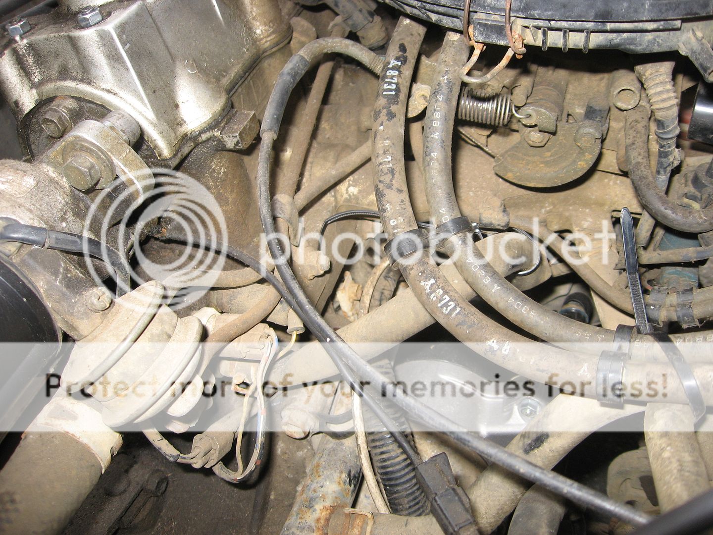

Went home and popped the hood to put the timing up again and found DOH! I had forgotten to put the vaccuum hoses back on the distributor!
Think those would affect emissions?
