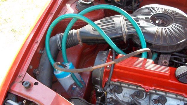

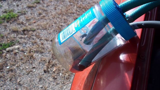

Here's the catch can/fart catcher, that Sphenicie built, for testing purposes.
Please note, the hose leading to the air cleaner slid down during inspection. :smackface A clamp will need to be added if more testing is needed. :deal But that's another story.......... :tumbleweed
If the oil, in the container, was more of a rich mocha color, then coolant leak/head gasket leak would be suspect. :news

Maybe. :hmm But you will have a very good idea of what's circulating around in the crankcase. :doper
