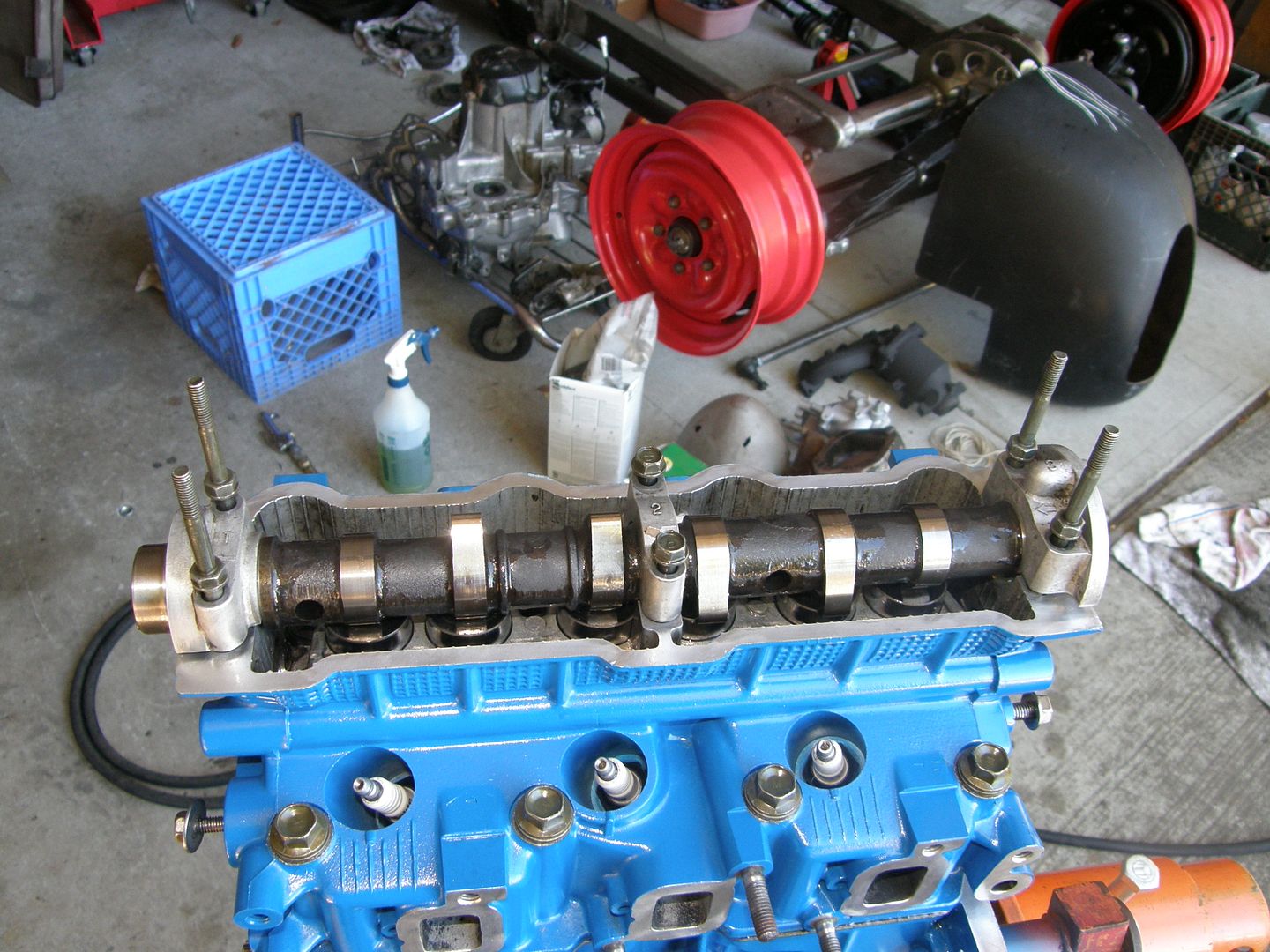

Yep. ![]() Just a little dab 'il do ya.
| Deleted User | Oct 14 2013, 03:35 PM Post #4 |
What Snowfish said. The application of the sealant on the camshaft bearing caps can not get into the the bearing surface for the camshaft. The amount that Snowfish has there is actually too much. Enough will barely be visible. Wait, that's my picture. But, anyway, that's just so you can see where it does and doesn't go. I'm using Loctite 515. Loctite 518 will work as well, and is more commonly available. Ultra-Gray will work, but is has to be so barely visible. You can easily plug the vent passage. If you do, your seal will blow right out. Also, a very little bit of Ultra-Gray RTV on the edge of the cam seal. |
