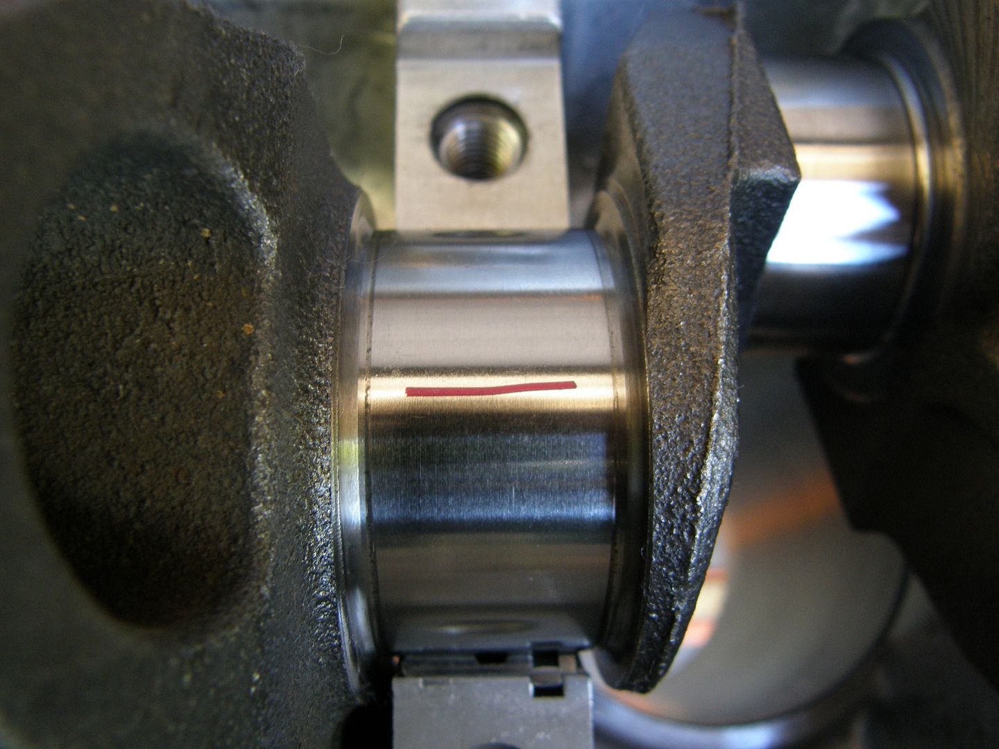

evintho
If you don't mind I'll add some pics to this thread. I'm in the middle of rebuilding mine and I just happened to snap some pics when I checked the clearances with plastigauge. Very simple process. Lay a strip on the journal, install bearings and torque down a cap, remove cap, measure with the enclosed gauge. If the machining was done right, it should be right on the money!

Smidgen
Smidgen
it looks like you used the red stick and measured with the green paper. As far as I know you cannot mix and match. It looks like you are closer to .002.

That's good info to know. I was wondering why his stick was red, mine was green and I have the green gauge strip. That brings up another question I had with this procedure.
I was thinking if you put a strip on just one side on the rod journal it would show overall clearance. This would mean that with the clearance distributed uniformly it would be one half what the reading shows. I looked up the plastigauge website for direction and it said on large bearing surfaces to use 2 or 3 sticks distributed around the journal. I put one on the top of the journal and one 180 degrees opposite on the bottom. Torqued it down and pulled it apart. It showed .001 on both sticks.
So if evintho is reading .002 on one side of his connecting rod journal, wouldn't that clearance be distributed as .001 all the way around?
