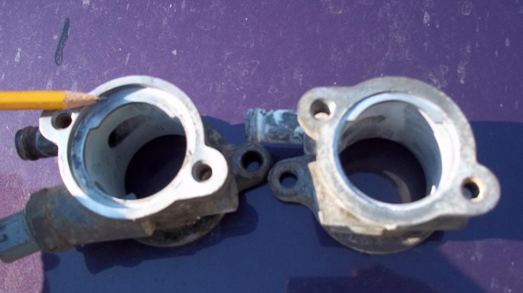

ascensions
Je conduis une petite voiture.
The rubber seals they sell at auto-huts, are not thick enough to seal the deeper water-outlet housings.
It's hard to see it here, but this is a new Metro gasket, and there is still a 2-3 mm space from the seal to the housing.
Now there was a TSB on the matter, but manufacturers supplying these auto-huts never updated their inventory to include the thicker seal.
You can buy it through Chevy at $25 a piece, or my preference buy the $5 Neon one at Auto-Hut.

No worries, I'm open, and accept all gasket philosophy.
It's worthy to note there are two water-outlet housings (as posted in another thread)...
If you have the shallower housing, I imagine the Auto-Hut seals will work fine. Unfortunately they list that same seal for later-models (or did when I replaced mine).

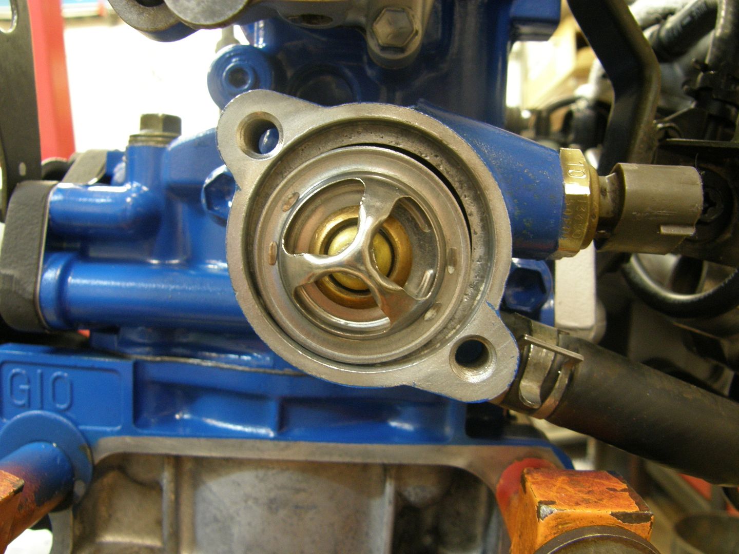

davegran
Old Fart w/Wrenches
Back in September when my wife & I made the pilgrimage to Washington state, the land of rust-free Geos, we stopped in Missouri first to get a rebuilt head that Geo Glenn had put together for our red '95 3/5.
It was to replace this one.... We discovered at the Minnesota Metro Meet that the compression was, cyl#1 - 180psi, cyl#2 - 70psi, cyl#3 - 120psi. :smackface
While we were installing it at his place, I caught some pictures of the process. Here is how he made sure the thermostat wouldn't leak. First he put a little bit of Ultra-Gray RTV on the flange of the water outlet.
Then he put the THM1105 seal from NAPA and the 180* thermostat into the housing with the dribble valve at 6 o-clock.
And when he torqued it down, just the tiniest little bead of Ultra-Gray extruded out of the joint. Perfect seal... Thanks, Glenn.
