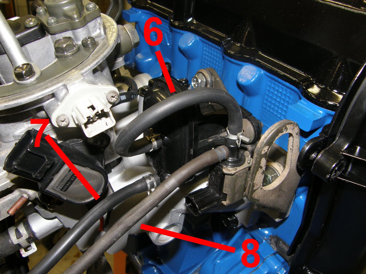

Vac lines #6 & #8 go to the evap canister purge valve. Go pick one off a Geo at your local Pick-N-Pull. Probably cost a buck or two. It's only a solenoid and they rarely ever to out.![]() |

For a follow up... I got a "CP220" on order.... This is used on a bunch of Suzuki/Geo models from 1998 on... Hose arrangement is nearly identical to the one shown on the post above.... Plug looks like it will fit per pix... Should be coming in today or tomorrow.. Will post results when I get it in... Thanks |
| truckjohn | Nov 2 2013, 03:35 PM Post #6 |
Sha-Zam! Goes right in... Tube arrangement looks a wee bit different, but otherwise - it's a direct bolt - in... Thanks |
