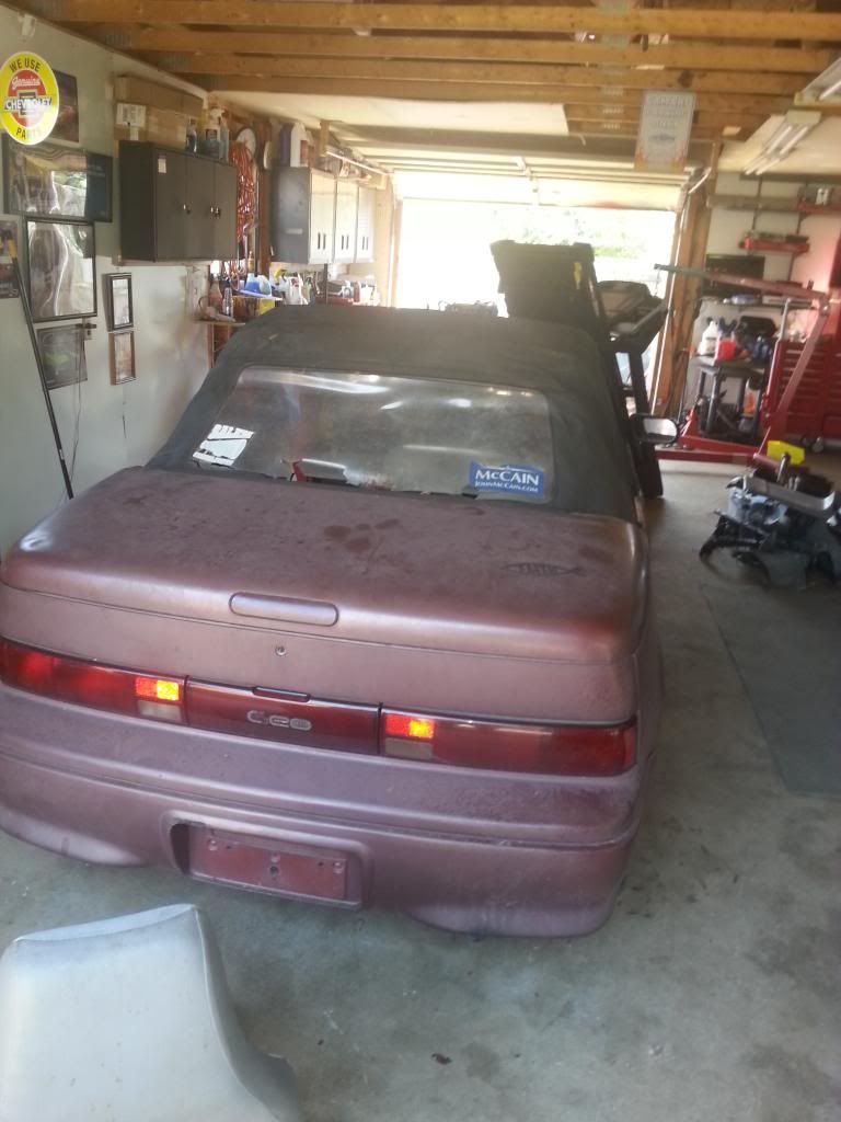

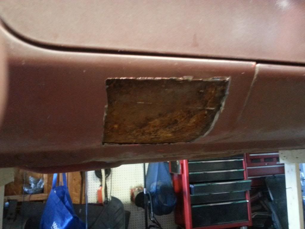

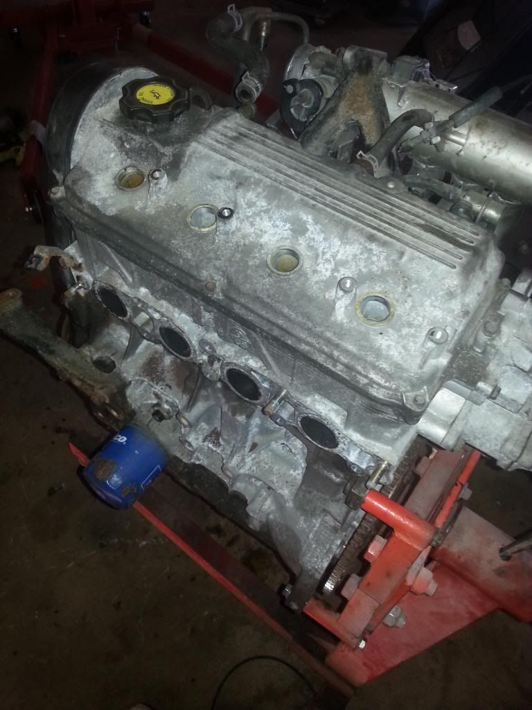

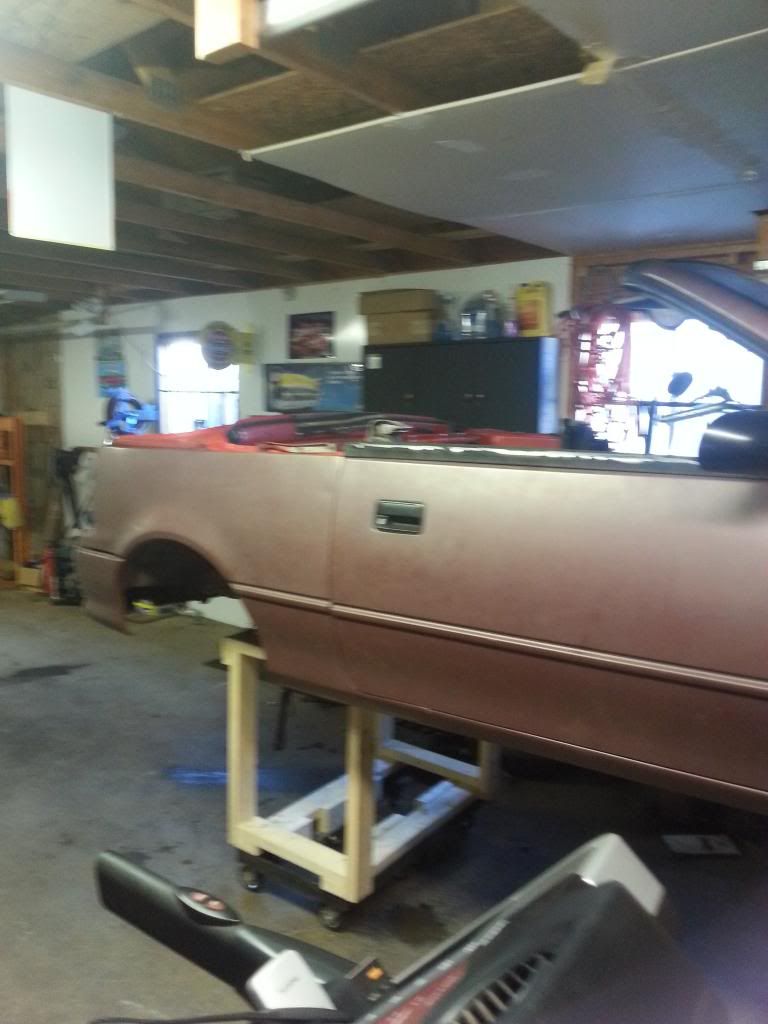

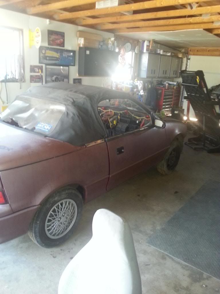

I thought i would share some pics of my 92 Vert project. It came with a 3/5 its gonna have a 4 banger out of a 99 with a 5 speed.Posted Image
Posted Image.Posted ImagePosted ImagePosted ImagePosted Image

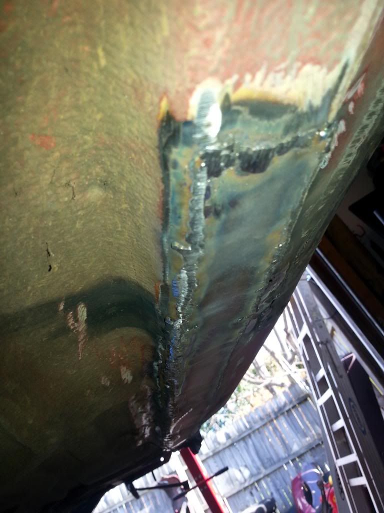

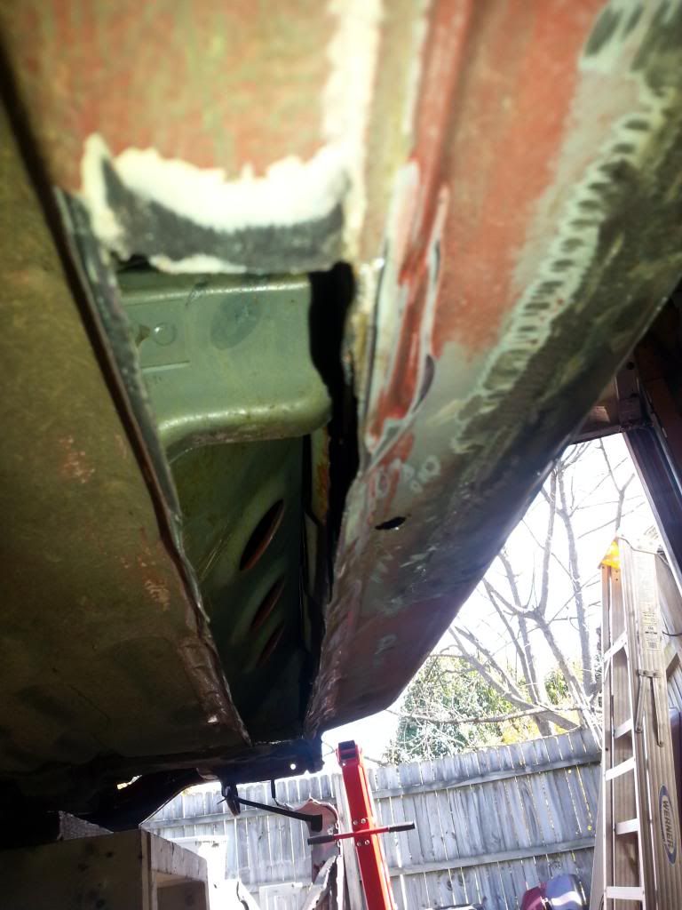

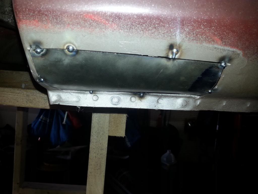

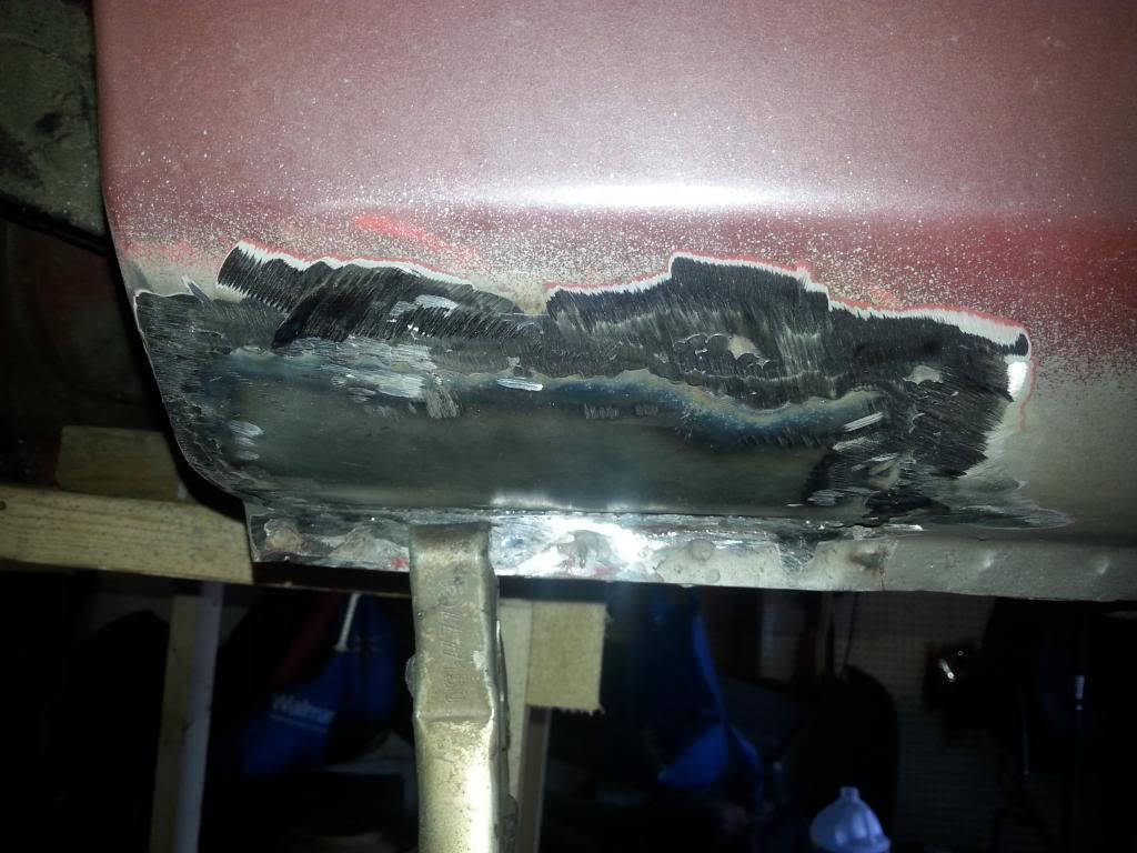

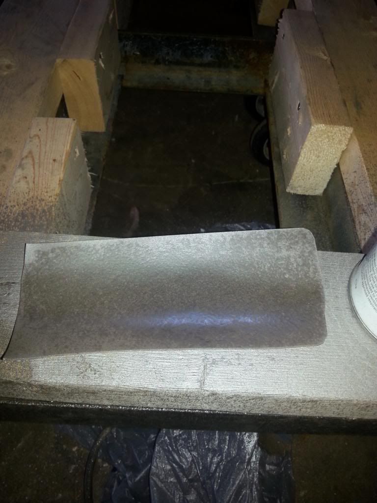

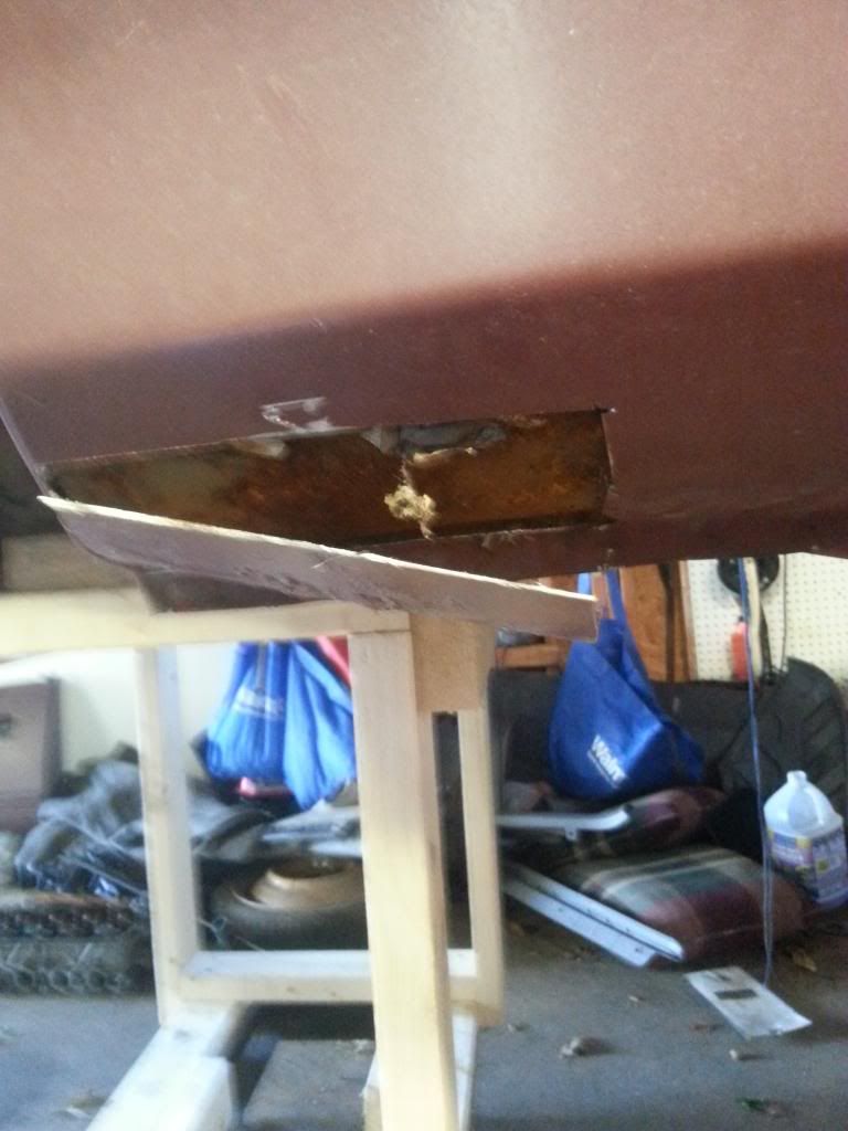

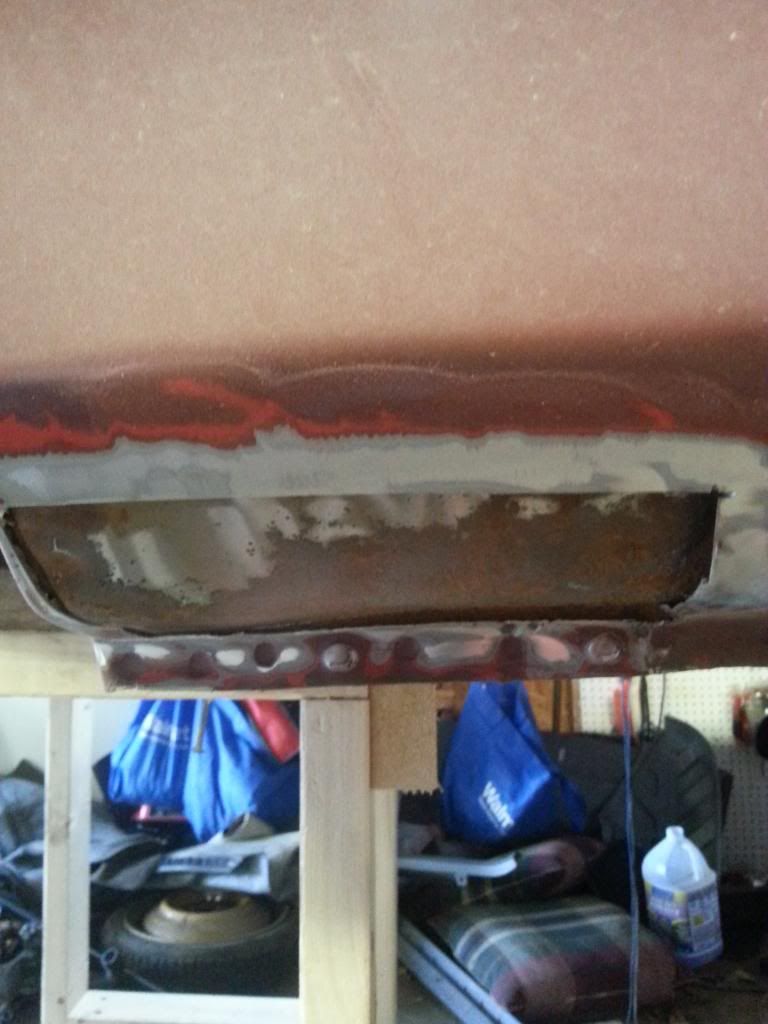

Some of the body work pics so farPosted ImagePosted ImagePosted ImagePosted ImagePosted ImagePosted ImagePosted ImagePosted ImagePosted Image
geo pet
" my strange addiction "
nice job so far buddy ! don't ya just love welding upside down ? lol
mdc689
oh yea welding upside down is my favorite..lol
I see you are using the G13BB "big block" like I have, check a few things before throwing it in.
1. Check the rubber rings inside the valve cover that keep the spark plug hole dry, they tend to become brittle and allow oil in.
2. Make sure you're good on coil packs, they are expensive little buggers on this engine
3. Make sure the water pump is good. Once you put this monster in it can be annoying to change the pump because of its size
Just some insight before you throw it in. Unless you plan on rebuilding it in which case you'll get to that :thumb

I planned on putting on a new water pump and belts. I didn't know about the valve cover though. I have overhauled a few G13b's never had a BB though. The engine is out of a 99 it only has 95,000 on it the wiring harness is for a 98 it has the coil pack on the end of the engine like where the dist. would be. I have that engine as well but it is done broke a piston and spun 2 rod bearings.

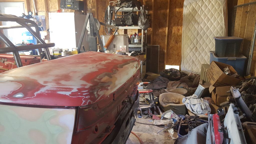

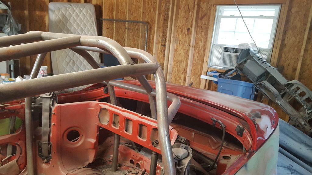

Sorry for the long hiatus between getting married and a new baby I haven't had much time to work on the car.

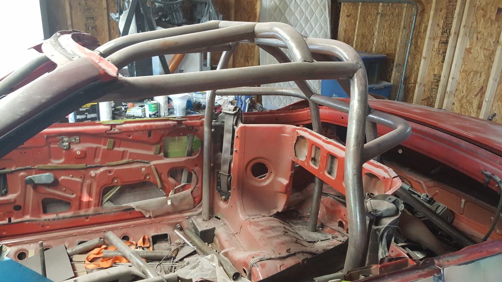

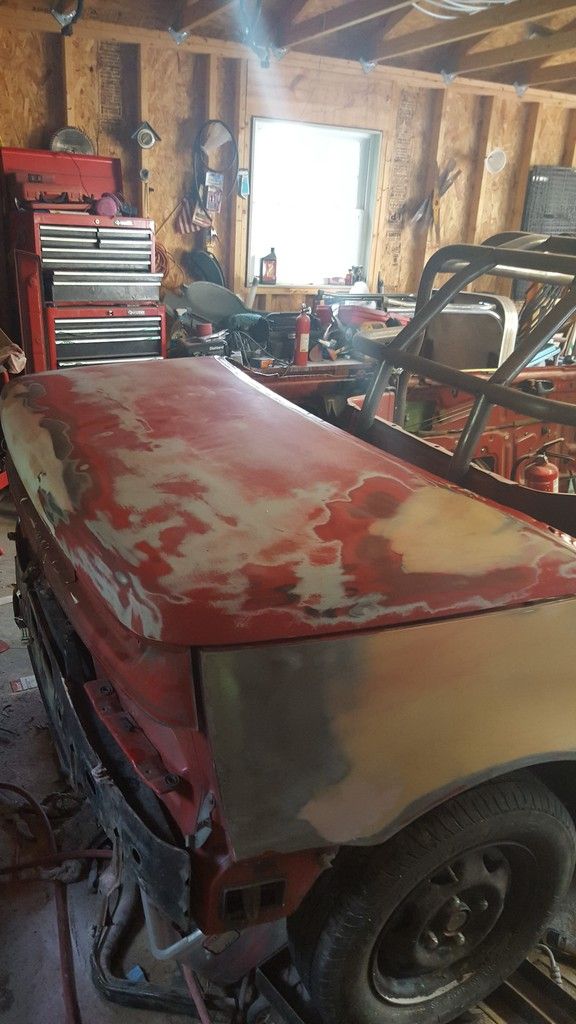

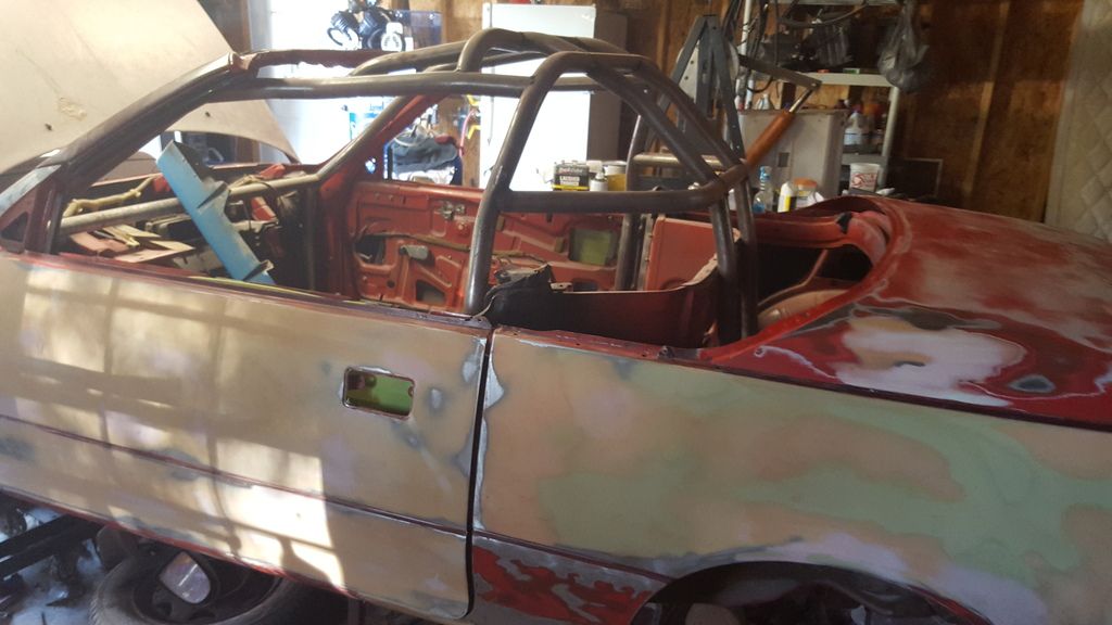

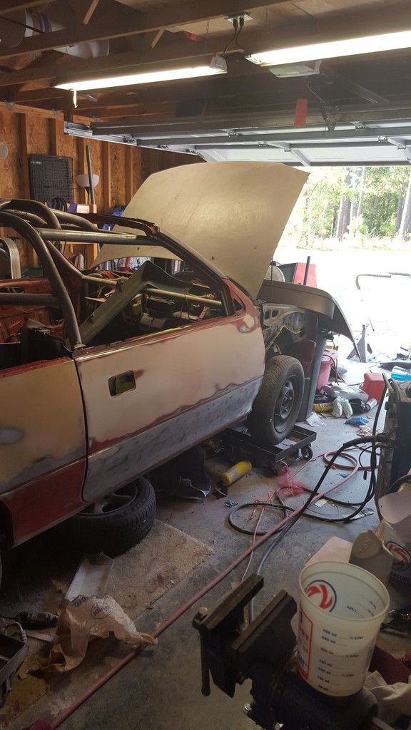

getting back into it now here are some pics enjoy.
{cleaned up pic posts - MMM}
Edited by Metromightymouse, Sep 14 2015, 11:30 AM.
mdc689
more pics
Edited by Metromightymouse, Sep 14 2015, 11:32 AM.
Stubby79
Ha, overkill! Love it.
