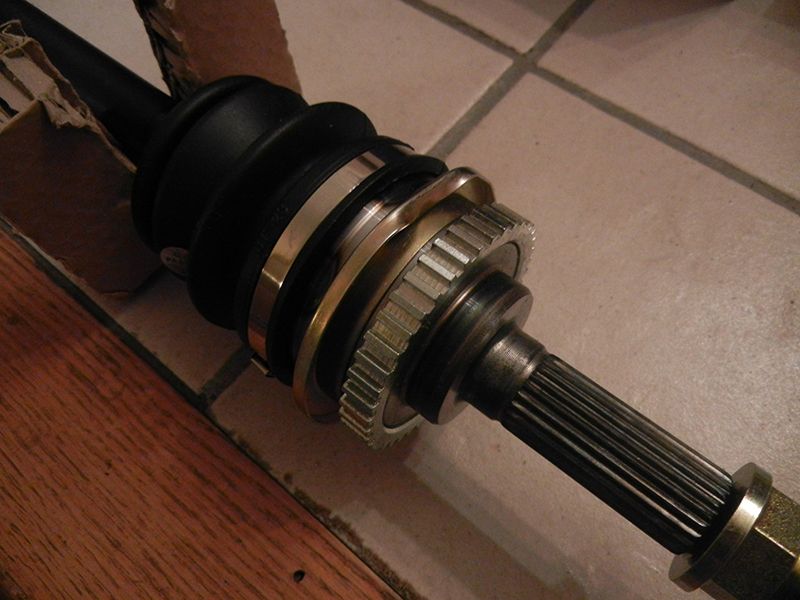

First things first; I was really glad that I made my purchase from someone with a local presence because this is what I found when I opened up one of the boxes:
Having never worked on an axle before, I was slightly panicked by the damage. I looked up the part on the Advance Auto website and checked availability of inventory at stores near me. They had one in stock 6 mi from my house so I ran down there. I didn't realize that the bent bit was just a dust shield for the ABS sensor. Since my Metro is non-ABS it wouldn't make any difference, but the store clerk replaced it anyway. Apparently this type of damage is not uncommon with GSP- the axles are not packaged all that well from the factory.
The second (inexperience) "issue" I ran into was the question of spindle washers. I thought I needed to replace them, so I ordered a box and they didn't fit the new axles. What I didn't know was that you don't actually use a washer with the (different from stock) nut that ships with these axles. I guess I should have figured it out by looking at the washer-attached-to-nut shape. Anyway, I got a refund for them without any problem. I believe that Advance policy is 90 day return guarantee for any reason, so you can order everything that you may need and return the stuff that you don't. :thumb
Very nice axles. You did your homework, and it will pay off in the long run.
The ABS dust shield and sensor ring will tap off if you're not interested in having them on your installation.

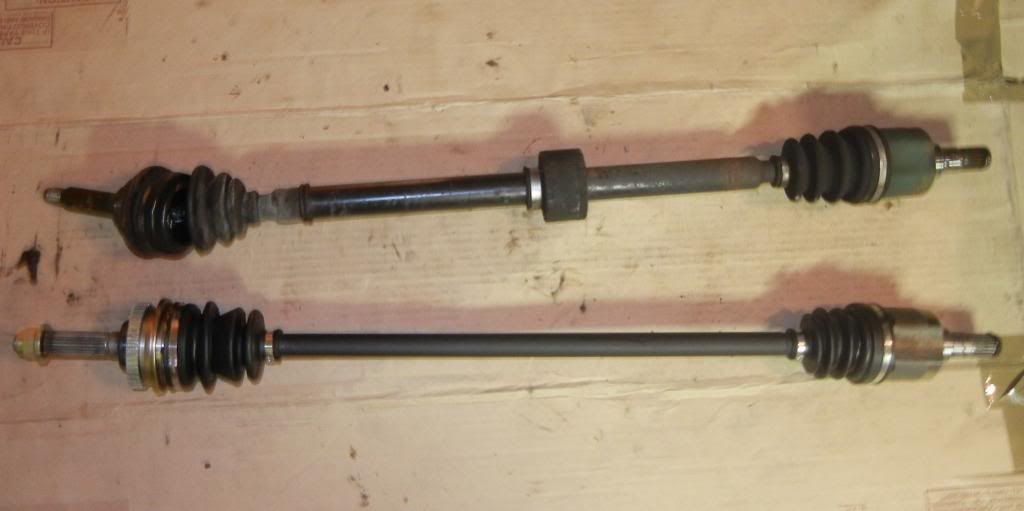

We started on the driver side and by the time I had drained the transmission, he already pretty much had everything apart. 3 bolts and the brake line clip out in a flash. Axle popped out easily with a screwdriver. Hard to see in the photo but the outside boot was ripped all the way around and the rubber of the inside boot was deteriorating badly.

You can see the ripped boot in this picture. I think the thing in the middle of the old axle is some sort of balancer or something. Anyway, another half hour and the Metro is back on the ground. Refill the transmission, take a test drive, and pack up pdqrunner's gear = 1.5 hours out the door. Seriously- if the guy ever needs a new gig he could run a NASCAR pit crew! Thanks a million, man! Hope I can help you out with something down the road.
