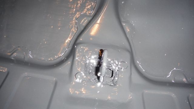

Yes, the latch can crack. :'( Previous owner trying fixing this one.
And failed! :die

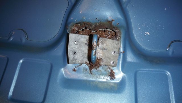

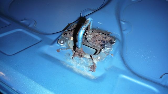

You'll need to install nuts & bolts like this.
This procedure was a factory recall. :news Most got ignored. :shake

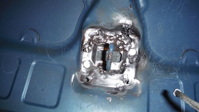

Welding that frog hair steel is really tricky. :gamerz I touch mine up for good measure.
The nuts & bolts would have been enough. ^o) But I wanted it to be just a little bit better.
Braced up, clean up, and rock solid. ^o)
Not super pretty, but she ain't going anywhere. :cheers
