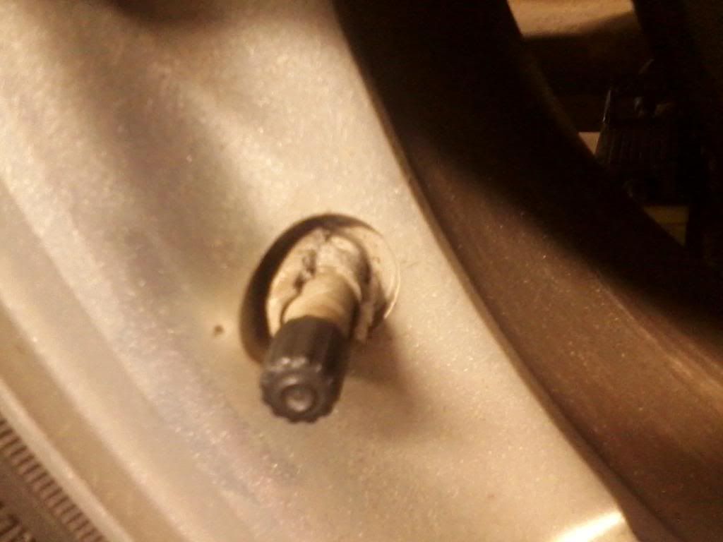

If you own a 2007 or newer model Jeep or know someone who does, please inspect the TPM (Tire Pressure Monitor) Sensors especially if you live in areas where rust and corrosion are prevalent. This is a serious safety issue and sudden loss of tire pressure can cause an accident. Every 2007+ Jeep that has come into my shop are having to need these monitors replaced because the corrosion buildup is causing the nut to split and crack or completely come off making for a dangerous situation. I am surprised there is not a technical service bulletin or recall on this issue. Inspect the wheel where the valve stem is and take note of the condition of the nut holding the sensor in place. This is what I have seen on 8 different vehicles in the last few months................ ![]() ![]() Just a heads up! |

Common issue with Nissans/Infinitis as well.... but there's a campaign/recall to replace the nuts. |

I deal with this shit at work all the time and they always break when we check them so its about $120 to get it fixed everytime |
