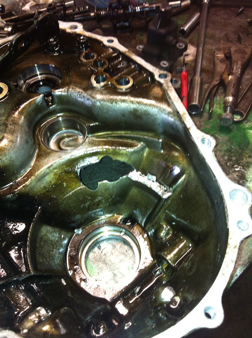

![]() Heres his problem. talked to him this morning. Edited by David95237, Nov 26 2013, 10:48 AM.
| Memphis metro | Nov 26 2013, 11:58 AM Post #17 |
Is that his? |
| David95237 | Nov 26 2013, 12:28 PM Post #18 |
Yes he text me a pic |

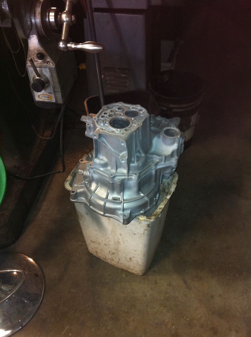

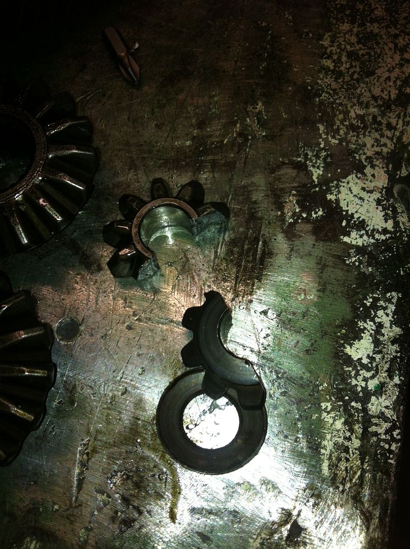

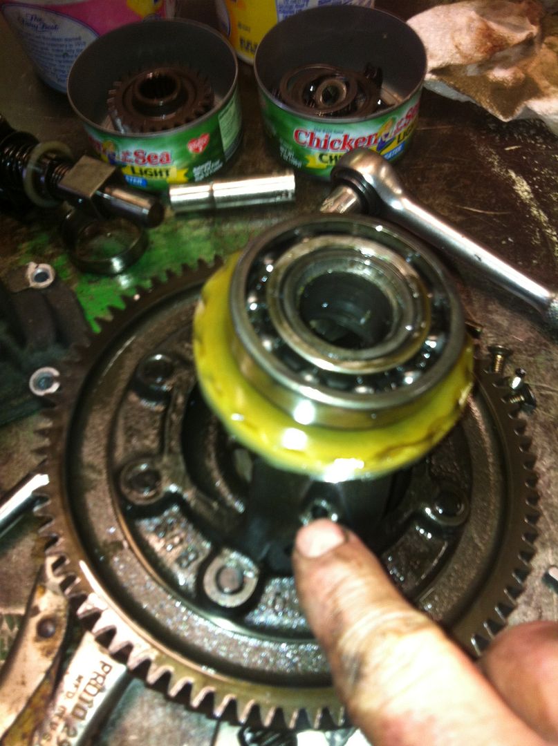

Finally got to tearing this one down. ![]() the roll pin broke in the differential allowing the shaft to float out into the case. ![]() Found these floating around the transmission. ![]() New case ready to go.
