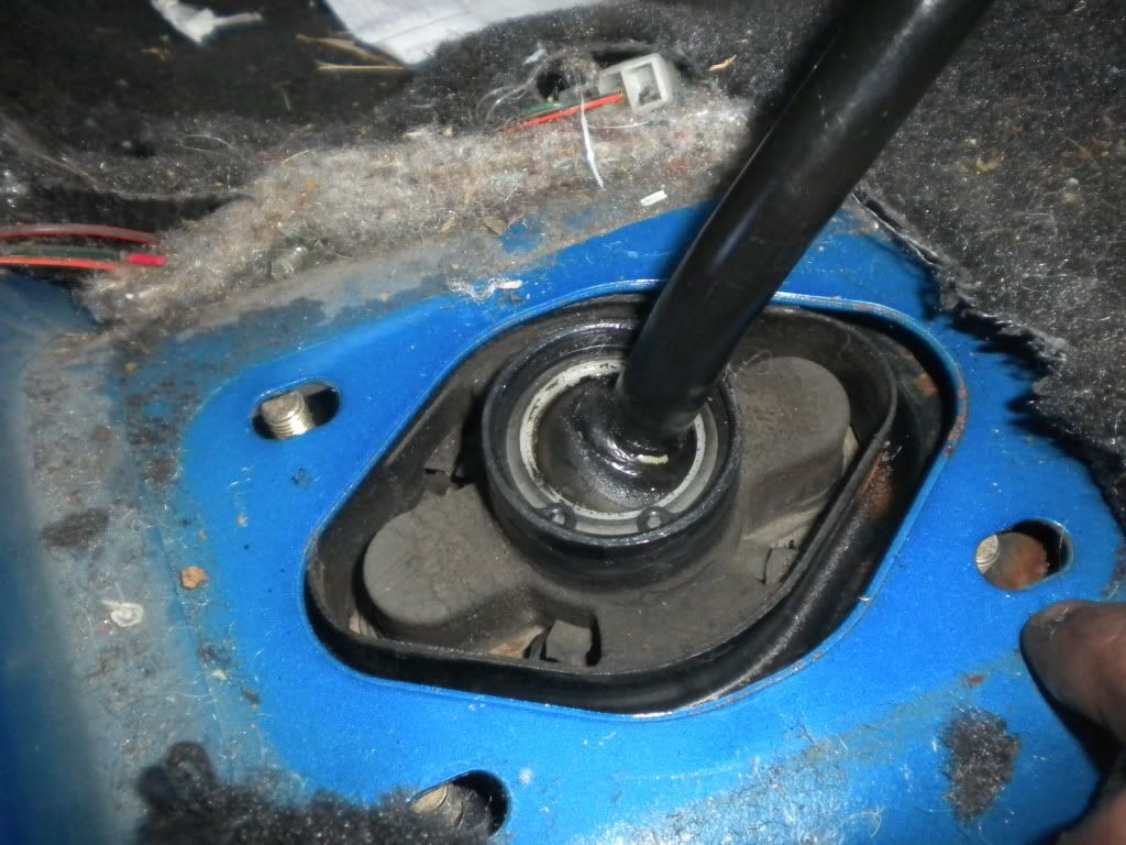

I found a thread of the assembly... DIY Short Shifter by Potter
Including a pic...
I'd think for it to drop several inches it would have to loose the 4 nuts at the top?
Including a pic...
Very helpful picture. By that, I am inclined to agree that its the nuts.
Okay, literally since I wrote the line above, my friends arrived to help get it on a Uhaul car trailer. Mechanic friend looked underneath and was able to point out where it was sagging. He too mentioned bolts. I am assuming he meant those seen in the picture.
I will try to take photos as I don't imagine there are many threads addressing this issue.
two pics in this post. look at the second one. bolts are missing. that's the bolts where yours has lost the nuts.

I got the car over to my mechanic friend's place. Can't do anymore till tomorrow. I can't explain this well right now, but the former owner that had done the "rebuild" is officially a fraudster. Apparently at a point where things connect to the transmission, there are 3 bolts. Only 1 bolt was used and it got sheered which it seems is the cause of this latest problem.

John, my mechanic friend was able to get the sheered bolt out. (The first image shows the distance the bracket separated.)
View gallery for full size high resolution images here: http://imgur.com/a/a1kvf
We determined that the bolts were Metric M10-1.25x30. I bought grade 8 replacements. There's no way the sheered bolt was grade 8. The bracket holes (no idea what the proper name for the part is - this thing) allowed too much play of the inserted bolts for my liking so I had the idea of wrapping the top of the bolts with Teflon tape to fill the void. The bolts I found were a bit long so I also bought some grade 8 washers to achieve the proper insertion length.
