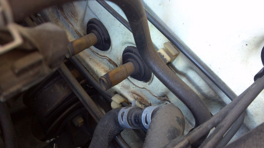

You can bypass the heater core for now, but you will have NO heat. Basically just disconnect the hose going from the intake to the heater core at the heater core. disconnect the hose going from the heater core to the water tube at the water tube. Attach the hose from the intake to the water tube.

"Basically just disconnect the hose going from the intake to the heater core at the heater core. disconnect the tube going from the heater core to the water tube at the water tube. Attach the hose from the intake to the water tube. "
This is what I need to do to preserve the block as well?

This is a pic of what you need to do (from my 2000 swift)
