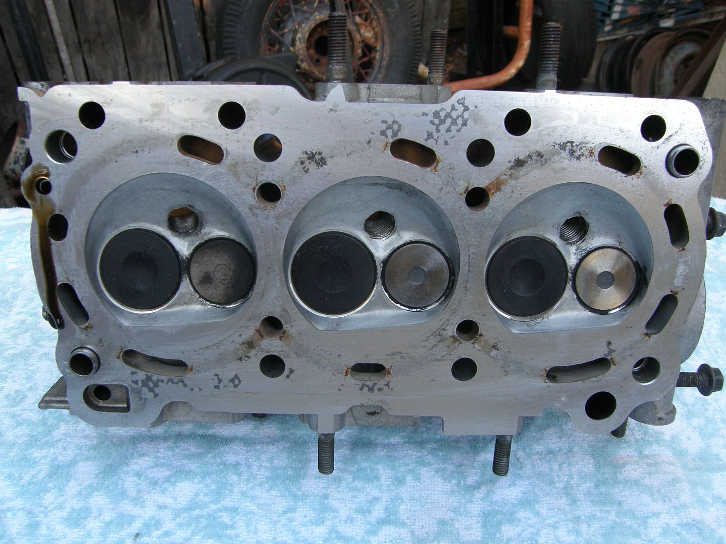

It is possible to find a 'useable' engine at Pick-N-Pull. Once you pull it, it's very easy to pull the pan, then some rod and main caps to check bearing wear. Look for major scratches in the cylinders, cracked pistons, obvious holes or broken pieces, the aforementioned cam saddles, etc. Burned valves are pretty common, too. Give it a thorough inspection and try to determine why it wound up in the yard. You're obviously not gonna find a pristine motor but you should be able to find something that'll run for awhile.
Stuff's out there. I was looking for a decent head at Pick-N-Pull and came across this unit that had just had some new valves installed, been decked and had a ton of work done. $40!
Also, it'd be well worth your while to sign up for Pick-N-Pull's Tool Kit Rewards program. It's free! They have several days each years with 50% and 1/3 off sales for members only along with 20% off different selected parts each week! They also send you coupons for free admission and $20 off coupons all the time! They just had a members only half off sale 2 weeks ago.
:gp
You've got to be careful at the junkyard. The largest majority of the heads that have had some work done to them that I have seen have damaged camshaft bearing surfaces. Damaged camshaft bearing surfaces is one of the major causes of oil farts. The damage is repairable, but not really worth it.
The highest percentage of Geo Metro engines that have never had the head off of the engine have perfect camshaft bearing surfaces.
You'll get an eye for what engines have had head work. Check for heads that are cleaner than the rest of the engine. You'll also notice the poorly fitting Fel-Pro, or other brand, distributor case gasket. The blue printing on Fel-Pro head gaskets is not hard to spot on the front corner by the timing cover.
Pop the valve cover off, remove the camshaft bearing caps, and take a good look before you get all excited about a divine find at the junkyard. Those cars are there for a reason.
