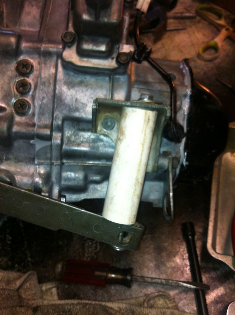

DON'T PICK THE TRANNY UP BY THE CLUTCH ARM
David95237
I like picking them by the clutch arm. So I fixed the problem, with the to bearing coming off.
