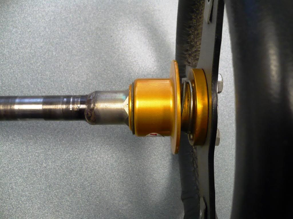

Here's the QR wheel assembly I have.
This is it on the steering column. To release, you reach through the wheel and grab the flange, then pull it towards you. It releases the wheel and your natural motion continues and pulls the wheel off.
This is what the end of the steering column looks like. The hex fitting is welded on and the wheel just fits over it and clicks into place.
This steering wheel assembly is from a Formula SAE race car our students built years ago. You would have to figure out how to bolt your wheel onto the release side, or scrap the stock wheel and go custom. Since we don't have power steering, I think you might want a larger wheel than this 450 lb car used. Your horn won't work anymore through the wheel button, so you'd have to find a way to work it. I don't know if you could salvage the turn signal cancelling function, but the steering column lock should still work just fine.
