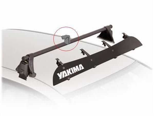

I actually have some Yakima rook racks lying around so I'm just going to use those as soon as I get a PM back for what # Q clips I will need. Now I need to think of an easy attachment method for the ladder :hmm
I have an idea but not really sure what hardware to use.
I'm thinking I'll have the ladder setup to where it's predominantly on the passenger side.
Here's a crusty looking depiction of a 90° piece of what could be angle iron or some sort of metal the same height as the ladder that way you can slide the ladder under the angle and not need to secure that side only the side closest to the passenger door. I'm just not sure what to use to secure the angle to the rack or a type of clamp to secure the ladder on the oposite side.
Suggestions?
Edited by N0equal, Dec 26 2013, 04:35 PM.
make two pieces like the one you have circled. place them facing each other an inch wider than the ladder. Place this set up in the front. forget about the one that says Yakima. instead get another piece like you have pictured. on it mount a 2 ft long bar 90 degrees to the cross member. make two more of the pieces you have circled. mount one on the 2 ft bar permanately. make the other slide on the bar. on the one that slides install a "knob tightener downer".
This way you can stand at the back of the car slide the front of the ladder thru the front (circled pieces) facing each other to secure the front (left to right and up and down)
Then you can push a step against the fixed piece in the back and slide the movable piece against the next step and lock it down.
Quick and easy and only one movable part.
