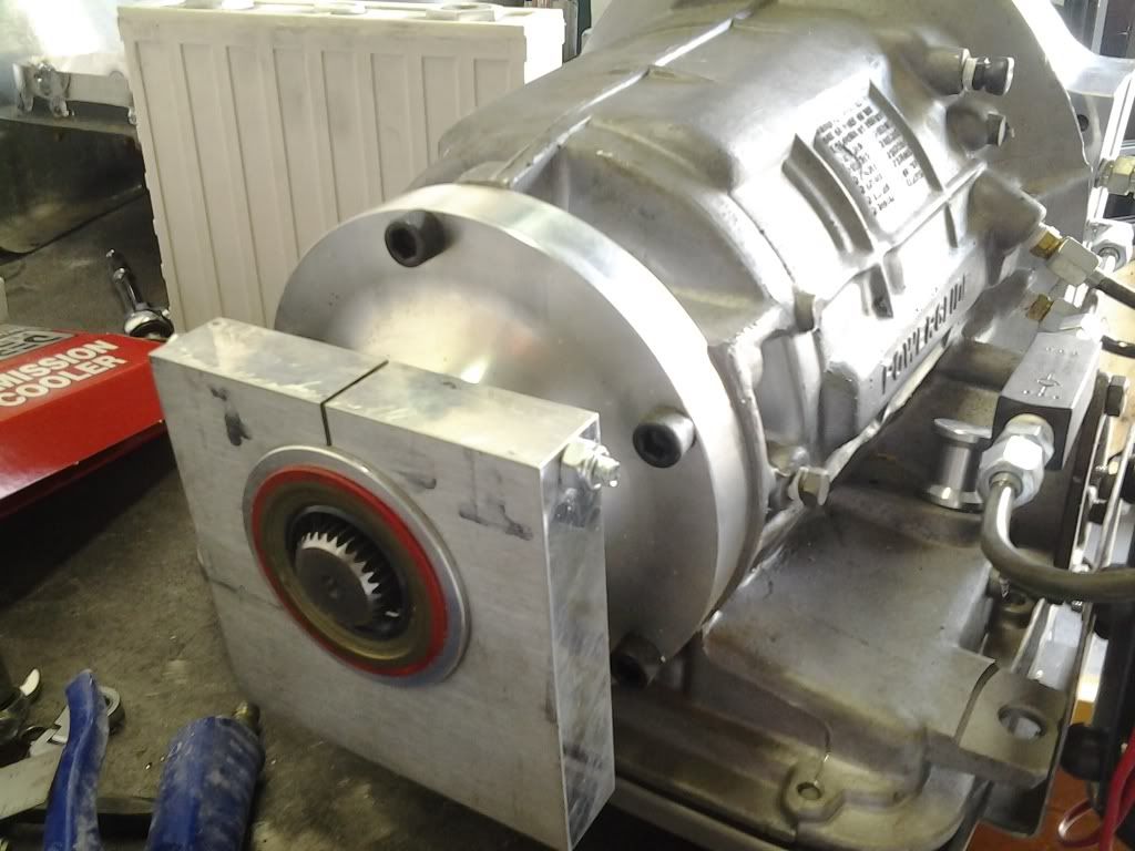

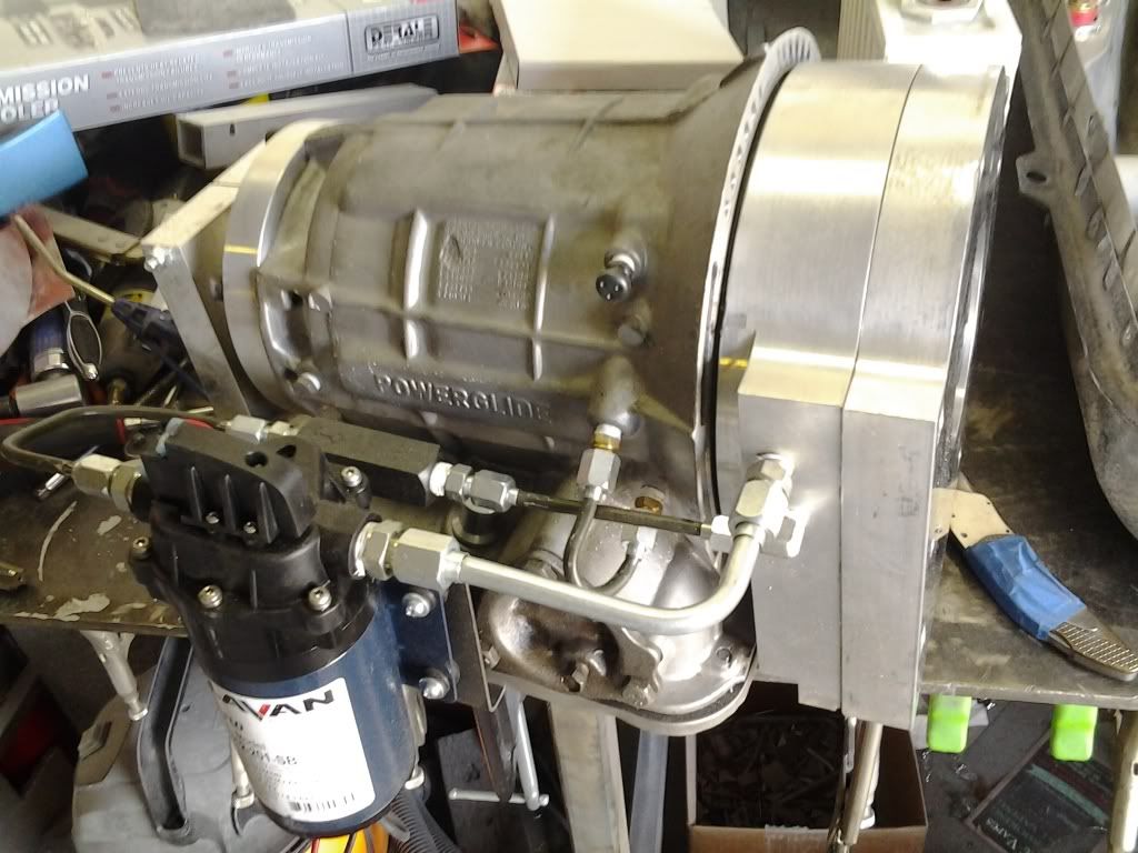

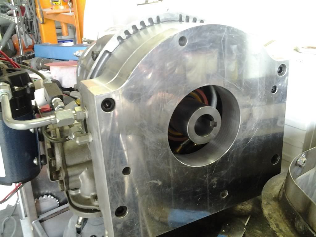

This is for another non Metro EV conversion that is not only getting converted to electric, but is getting converted from front wheel drive to rear wheel drive as well. ![]() I have been contemplating a rear wheel drive Metro for a long time because of the problems that I have with wheel slip in these Metros at speeds below 30 mph, and this set up would make a metro stick a little better. I will see how this 2 speed power glide works out in my other conversion project first. In my electric metros, I start out in 3rd gear, and go right to 5th, so this 2 speed is probably the ticket. This end is set up for an electric motor to bolt right up and has a custom input shaft with a keyway for the electric motor output. The electric pump maintains pressure when the car is stopped since the bell housing is sawed off of this and there is no torque converter. (torque converters don't do anything for a car that has no idle) ![]() This transmission is set up with a manual valve body and has no tail shaft section. Roughly the size of a Metro transmission. I could fit the motor and transmission under the hood, and run a drive shaft back to whatever rear end that I fab in.
