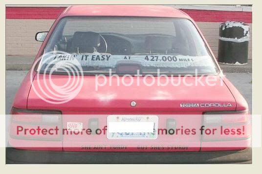

Right now my priorities are to keep this car running:

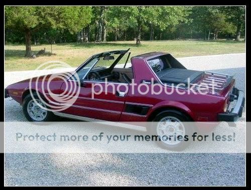

While I bring this one back to Life:
Then I can decide if I really want to make a run at 500,000 miles in this POS:
All it needs is a $65 Timing Belt Combo w/Tension Pulley and $185 worth of ebay available Struts.
It's had a complete Exhaust & Brake Systems overhaul within the last 20,000 miles and the Engine runs great as long as I stay out of the mountains. Somewhere around 5000 ft, it starts whweezin' hard and can't pull it's own weight up a little 30 MILE hill out of Albuquerque.

Think about it! . . . Another 56k out of it would take a big load off the other two for at least the next 3 years, so those cars should last me forever. With the Yota & Geo for Daily Drivers, I can get the Fiat into shape to at least drive it too the Car Shows.

Fiat X19. Thart10, speakers in the headrests. That was sweet.
