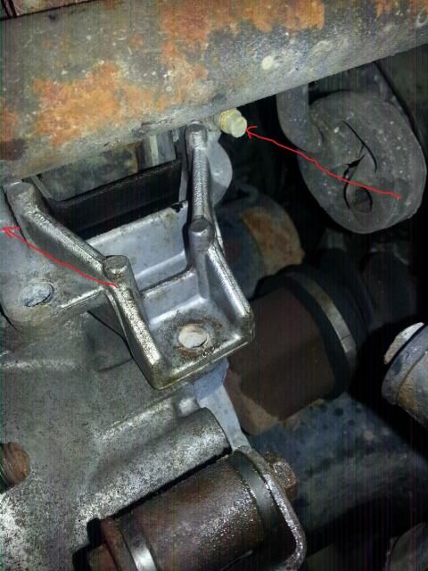

Okay I'm stuck. I finally got this brace undone.
Is this the side I need to loosen to get to the clutch? Or the side face the engine?
Do I need to remove the passenger side axle?
Edited by xElliot, Jan 15 2014, 08:26 PM.
I believe you are going to need both half shafts out. Either the engine or the trans has to essentially be removed from the car as the input shaft has to be completely out of the clutch pressure plate, and I suppose it's possible to unbolt the pressure plate by rotating the engine to access all the bolts, but it just makes more sense to me to drop the trans to the ground or all the way down on the jack so you can access all the bolts and do the disassembly and reassembly without having to fight for access.

I have reached a problem. One of the bolts I need to remove is A) almost stripped on the head and B) in an impossible area to get to thanks to my straight exhaust.
socal geo garage
You don't need to remove those bolts or that motor mount bracket,remove the two 14mm you are seeing when you look up you will need a deep socket 14mm,remove both axles, and the flywheel splash cover window 2- 10 mm bolts] remove starter ,and don't forget the hidden 14mm bellhousing nut/stud its below the starter,drop the trans down....... that bracket does not need to come off to remove the transmission.
