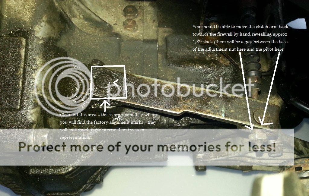

The car runs without pressing the clutch while in gear. Clutch isnt disengaging?
Here is the clutch arm

There is tension. I cant move the clutch arm by hand.

xElliot
Jan 22 2014, 01:15 PM
It sounds like you may have the cable adjusted too tight. You should be able to move the clutch arm slightly by hand, I've attempted to illustrate in your photo: Posted Image
