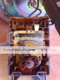

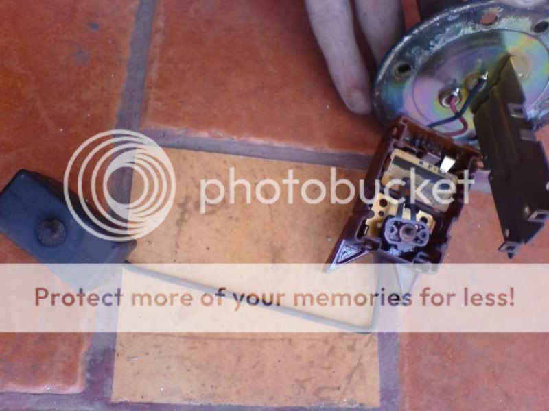

And this is what it may look like inside...![]()
