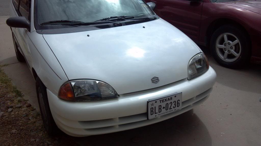

If you are really determined to have a good straight front plate (makin' up rhymes!) then you could take off the bumper and drill the holes through. Then you could get the license plate holder from a 98-01 metro and trim it to fit an older bumper. Attach it all together and thread the screws through the bumper, put nuts on the end of the screw and voila! A ridiculously over-imagined front plate holder that wont bend the plate.
Here is what I mean by 98-01 license plate holder, this is the one from my 2000
I was not too choosey. I just drill two holes in the middle of my plate to match the holes in the bumper. Then I jammed two hunkin #12 sheet metal screws thru the holes and thru the center of the bumper.
Took a hammer and rolled the top and bottom to fit around the bumper----Been there a few years
