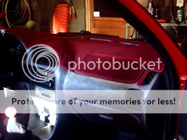

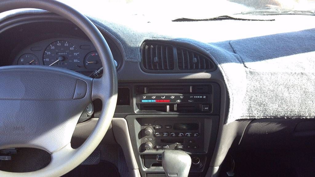

In a word... Carpet.
$39.94 on eBay for 1995 Geo Metro Dash Carpet
In a word, Yuck. Always hated the way those look. If it doesn't offend your sensibilities it is a good solution.
Agreed.
Face it, if god had meant for man to cover his....*cough*...dashboard parts, with carpet, he would have created (sometime on the 5th day, immediately following the creation of the duck billed platypus, but right before Jeopardy comes on. That's god's favorite show; he gets all wrathful and junk when he misses it.) a mini Roomba, one the size of a hockey puck. Of course, it wouldn't be until after Tesla was born that we'd actually figure out how to put batteries in it and use it.
You should see my dash cover, it is a factory piece so it looks amazing. Not like the aftermarket ones at all! My dash is from 2000 though and has never seen a single day of sun so it is pretty pretty :lol
