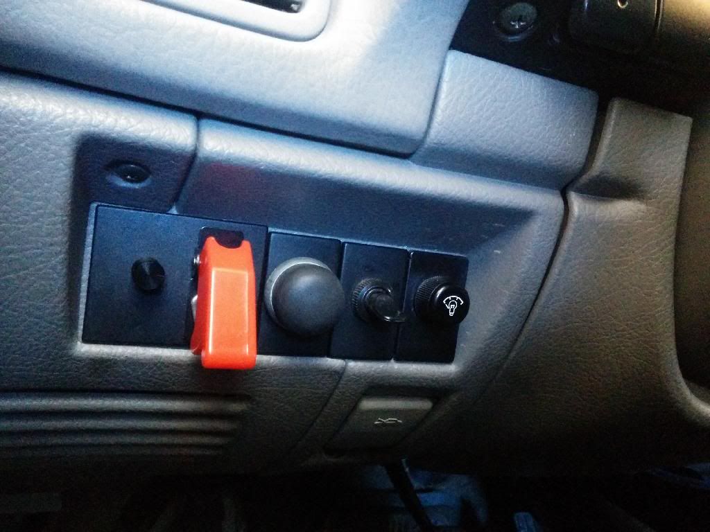

rmcelwee
Use a relay and some arcade push buttons. I got a lot of nice comments on mine.
(FWIW, that panel is a clipboard)

Mine is hooked up 2 ways.
The switch works/acts exactly as it should,
then,
I have a second, momentary push-button on the dash for the starter. They are wired in parallel, so you could use either one to turn the starter.
Something like this should work nicely.
