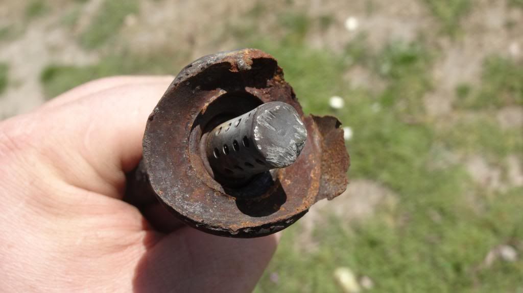

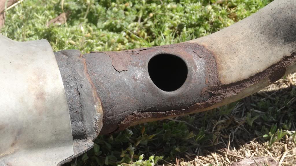

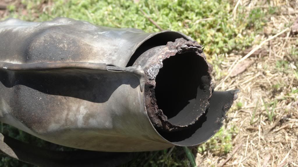

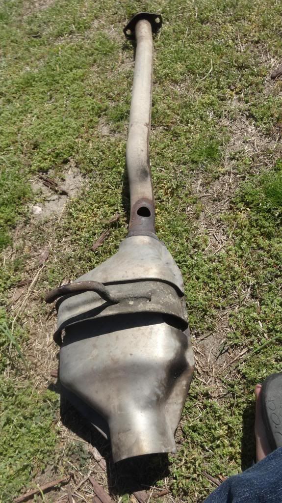

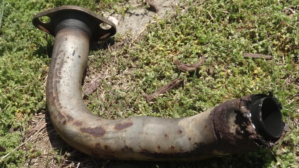

since i got the car a few years back i have heard a whistling coming from the exhaust, i located a small hole, it was after the 90 right before the cat. A while back, the exhaust got really loud, I looked under and noticed the 02 sensor bung because disconnected from the pipe. Yesterday I took the entire CAT off. the entire weld around the cat was bad and saw the wires to the 02 sensor were melted pretty bad(I will try and get pics later). I considered disconnecting it and just soldering a new section of wires on, but decided to see how much a new one was, thats where I am now. But overall, I do need to replace the entire cat section |

ive looked over the exhaust and it doesnt seem to be in to bad condition. i def have to replace the cat and 02 sensor. here are some pics i took earlier.![]() ![]() ![]() ![]() ![]()

the sensor bung coming off of pipe is very common thing I've fixed quite a few good luck with your fix |
