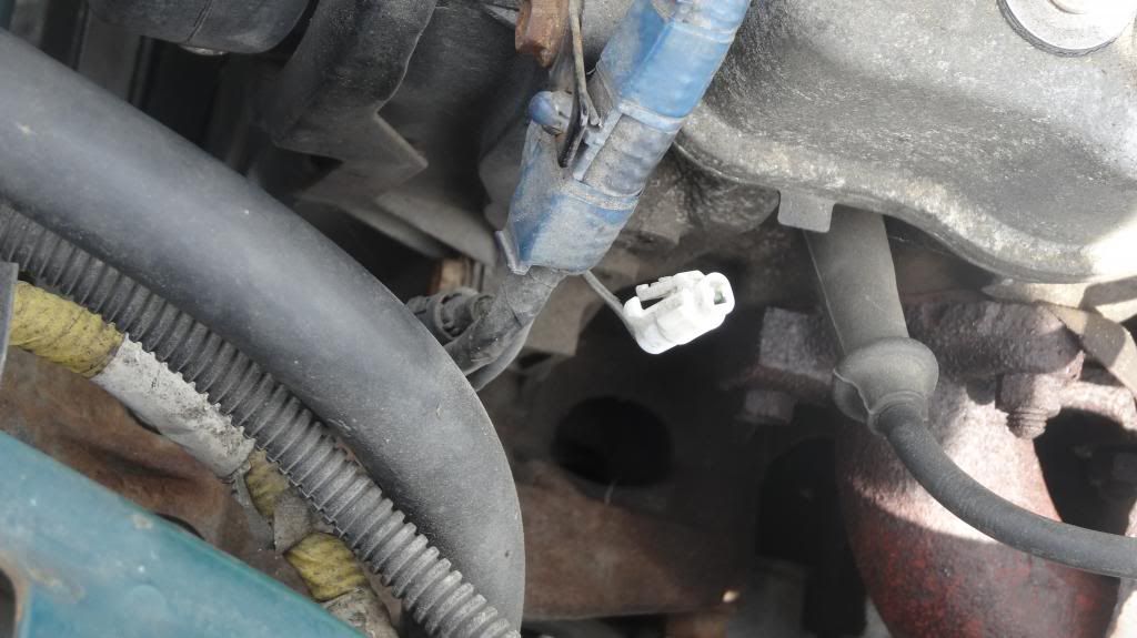

| Can someone identify this connector? | |

97 Metro 1.3L 2 DR HB Can anyone identify what this white connector is for/connects to??
| Hotrodray1 | Apr 24 2014, 07:07 PM Post #2 |
Over Educated parts guy
I think that one was for the power steering pump pressure switch. I have seen these on a few of these cars the last 98 I worked on had it conected to the power steering pump! |
| Woodie | Apr 25 2014, 03:20 AM Post #3 |
Ding ding ding, Hotrodray1 wins the prize! It tells the PCM to idle up when the P/S is working. |
| aartod | Apr 25 2014, 07:54 AM Post #4 |
I have a similar connector in the same spot on my 92- I have always wondered what it was for! I assume the same thing as yours! |
| Hotrodray1 | Apr 25 2014, 07:58 AM Post #5 |
Yea it seemed that they included it in most of the wiring harnesses never seen a metro with power steering but 4 dr sedans! |
| Cyborg | Apr 25 2014, 08:51 AM Post #6 |
McDumbass
ok, thanks guys. Its been hanging there since I got the car and it bothers the heck out of me that something is missing. I might cut the connector off and tape the stupid thing to the harness so I dont have to look at it. swinging. |
