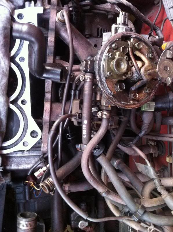

I am not sure I have a EGR? I wonder if the previous owner removed it.
Someone probably changed the hood.
The majority of 1991 Geo Metros did not have EGR valves.
What's the VIN?

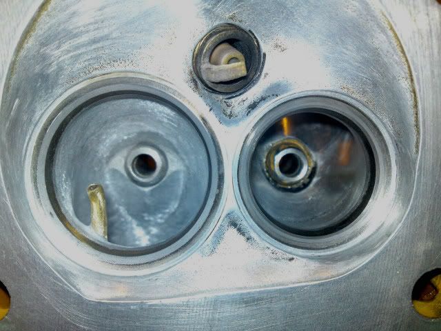

The head has tubes in the exhaust ports just above the top of the valve for an EGR. I assume there is no benefit in cleaning them?
No need to get completely sanitary with cleaning the passages. A little scrape and blow before you drop off that head at the machine shop will mean that most likely it will come back spotless. I use a drill that's slightly smaller than the hole in the head, followed by a small ball stone honing. The passage in the exhaust can stay carboned up for the rest of time. The archeologists need something to date your car with, just in case the data plate gets lost. ^o)
You talking about these?
That's not the exhaust port, and they have nothing to do with EGR.

I assumed it was the exhaust but didn't really look I guess. What are the tubes for.
t3ragtop
those are "swirl tubes." i have just ground them off while doing the old port and polish on g10 heads and never noticed a difference. :P
91 verts didn't have egr valves. there's no wiring from the ecu to support one, either.
clarkdw
The "swirl tubes" on regular emissions cars (pre-94) run through passages in the intake manifold and are connected to two small drillings in the bore of the throttle body that are covered up by the throttle plate when it is closed.
On 94-95 "upgraded" emissions they are connected to passages in the intake manifold that provide the signal for the MAP sensor and the fuel pressure regulator. I have not inspected any 96+ but judging by the similarity of the controls to the 95 I would assume that the tubes are connected the same way in them.
Edit: Oops, too fast an inspection. They also go to a port adjacent to the throttle plate but a single one and not covered when the plate is closed.
