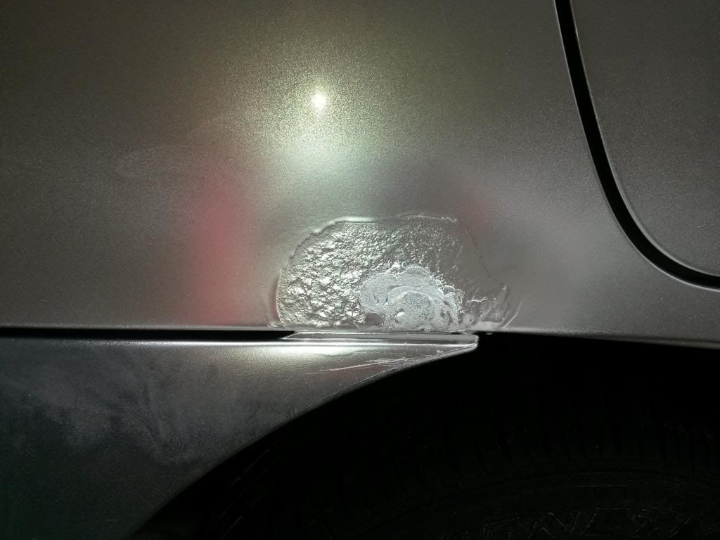

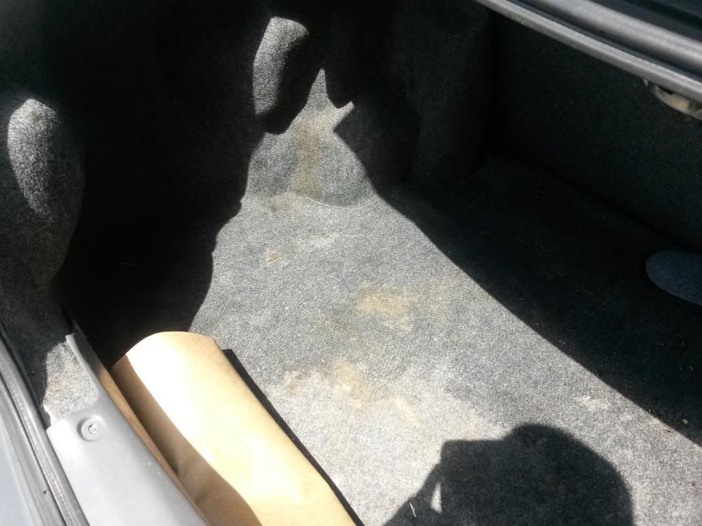

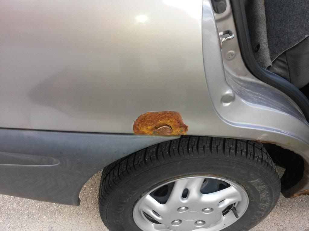

| faygoninja | May 1 2014, 11:08 AM Post #26 |
ok, so this is what i found. correct me if im wrong but i think my wheel wells are good but whatever these are are in bad shape. pass side trunk the hole above the wheel well pass side inside drivers side trunk little hole big problem pass side outside
| Metromightymouse | May 1 2014, 12:22 PM Post #27 |
That would be from the wheels throwing the road salt onto the underside of that area until it rusted away. Know how to weld or have any good friends that do? |
| faygoninja | May 1 2014, 01:20 PM Post #28 |
I am a welder. Though I dont have one. Temporarily I painted the rusted areas and filled the holes with expanding foam. It should rain today so we will see how it holds up. Long term I gotta get some metal in there. |
| faygoninja | May 2 2014, 11:41 AM Post #29 |
ok so here is my temp fix for the trunk holes. i painted the rusted areas to slow the corrosion. then got expanding foam and filled the cracks and the gaping holes. let that set up, then trimmed it down to a "flush" level with the trunk floor. then a final layer of paint on top of the foam. and yes, the foam can be painted on. ![]() ![]()
| exo | May 5 2014, 02:02 AM Post #30 |
The left rear wheel well on my 97 Swift are shot. Seriously, I can see the interior plastic. When it rains hard, my rear floor fills up with water. |
