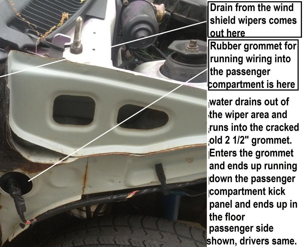

First remove the windshield wipers and grill under them and cleanout the rats nest / leaves on each side that may be blocking the drains. Then:![]() Reason I knew about it is that 3 years ago on our first trip after Geo purchase we ran 100+ miles in a driving rain storm. Wife ended up with her feet in 2 1/2 inches of water!! traced it down to that 2 1/2 inch grommet completely missing. |
